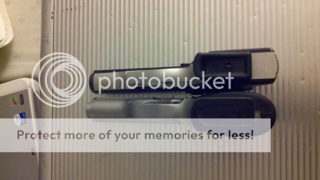

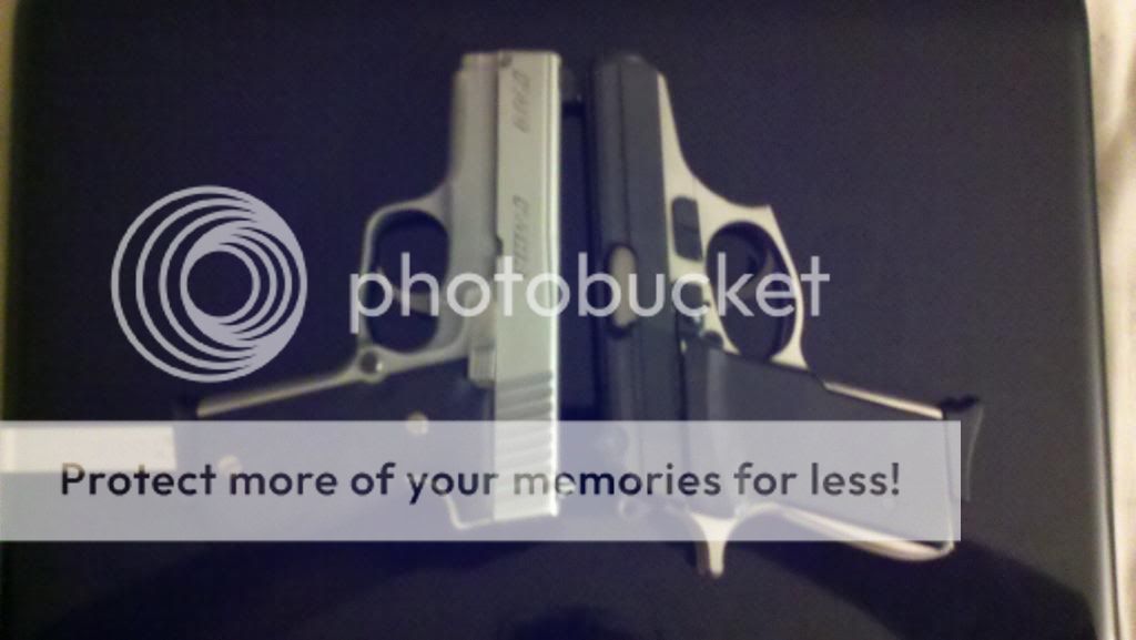

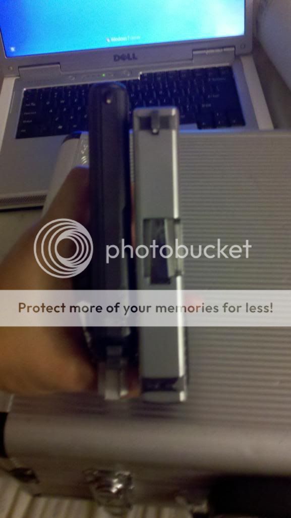

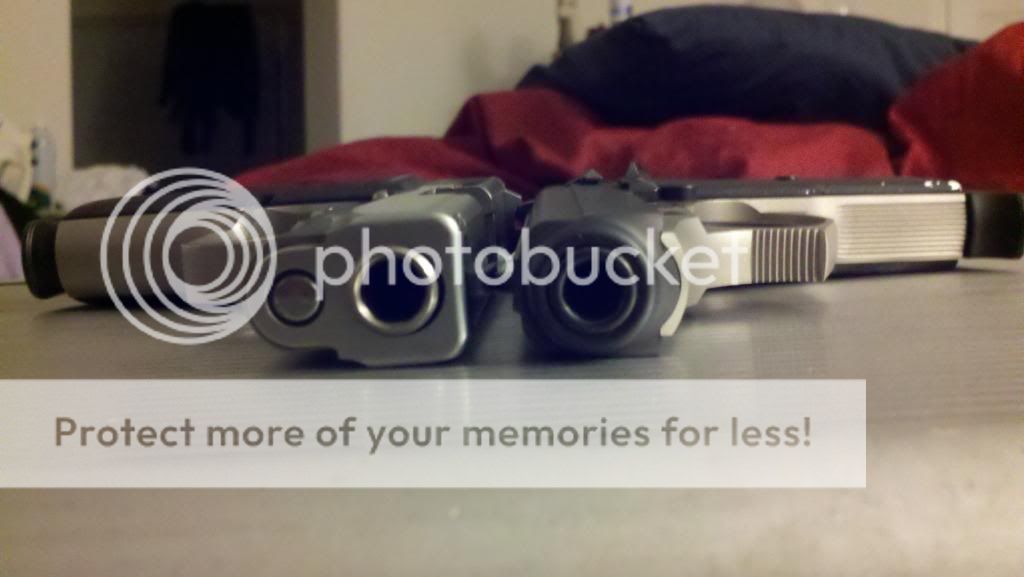

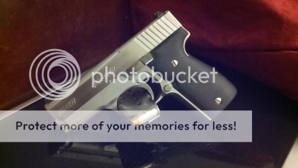

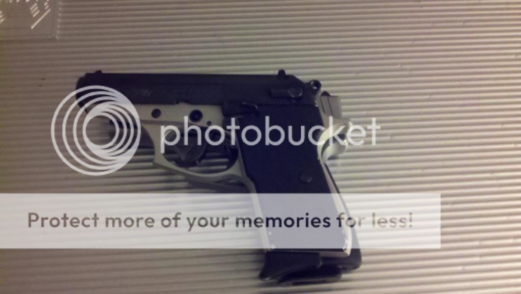

    And now for the pics. I'd post pics of my target but the previous owner, Bubby, drifted the rear site to the left to suit his poor shooting skills. Idiot. I'll have to drift it back to center. Groups were in the 1 inch size at 10 yards. Pics are from my cell phone too, sorry.

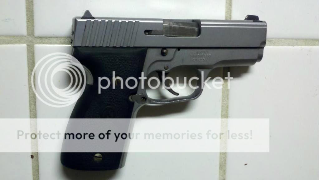

    The before pic. ....

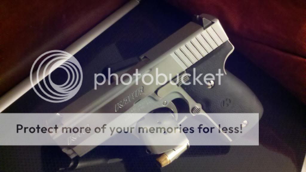

    And after....
    K40 compaired to Bersa 380....
    one more.....
      Dang! That's impressive! How much did you get that junkyard dog for, before you turned it into a jewel?!
        Excellent pics, I really love my K40! The thing is flawless. Good luck with it.

          Thanks guys. I paid 6 bills after transfer, shipping and DROS fees which is probably more than it was worth but I really wanted the early year models. Its very hard finding one of the older K40s. People just don't want to give them up and we all understand why. After it was all cleaned up it was obvious that it had very few rounds through it. Rails were very rough with no wear marks. I think I made out well and that means I paid the right price. Love that free market .
          I'm just amazed at the design. Had a lot of time to study each part and its function. It is just beautiful how well its put together. The detail is awesome. I made the mistake of selling a Kahr once, it will never happen again.
