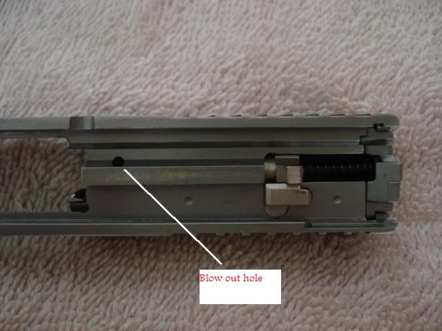

        Word of caution with the blow out hole....wear eye protection, or squint and look away. Some of that high pressure cleaner has a habit of spraying straight back at you. I got some brake cleaner in my eye last week and it sucked for about an hour.
        And just in case anyone is too shy to ask... Here is the blow out hole.

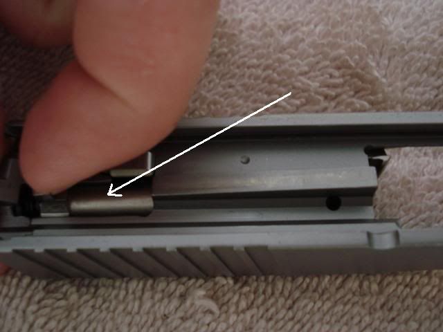

          Originally posted by kb2wji View Post
          You know, looking at this pic, I have an idea. If your Ripley striker spring tool is not too long, you could insert it in front of that pushed back striker and then blow away with the cleaner or even insert a Q-tip moistened with cleaner to wipe out the channel. What do you think? Doable?
            When I get light strikes, I know yesterday would have been often enough
              JFootin: very possible. If you keep the spring back you can get a real healthy dose of cleaner in there too.
