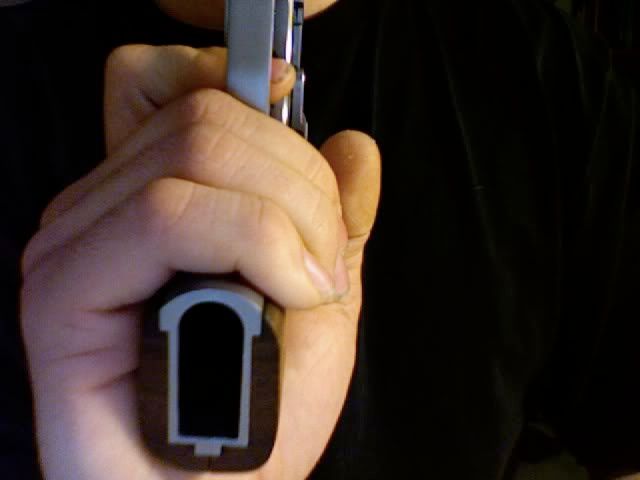

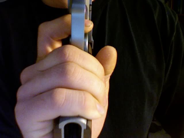

                It IS you. While it is very true that no 2 guns of the same make/model/caliber will shoot to the exact point of aim, we're dealing with pistols, not 1/4 MOA repeatable bolt actions here. When centered in the dovetails, the sights will be close enough to poa that most people won't be able to notice. The same is true about the height of the sight. You'll find that almost every 5" 1911 with novak sights runs a .175-.180" tall front sight post, though the officer models are much taller. Fixed sights are close enough to not worry about, IF you do your part!
                Most people that are used to double actions are NOT used to how close the backstrap (hence the palm) is to the breaking point of the Kahrs (which is at or slightly past vertical).
                Like it or not, that's how it is with these guns. You HAVE to revert back to basics and focus EXTENSIVELY on that trigger finger and isolating it's movement.
                If you need to drift the sights, and you do so to make it hit point of aim when you grab the gun and just shoot, that's fine and dandy - but that is no way, shape, or form, the fault of the gun, solely the shooter. Would this matter in a defensive situation? Well, having damn near been there, I don't even remember drawing the gun, but it was right in front of me pretty quick. I highly doubt you'll be looking for a sight picture at all.
                Short of a burr on the crown or a very very loose sight, excessive windage is almost ALWAYS the shooter, not the gun.
                Most people are aware of the whole "put the pad of your index finger on the trigger" aspect. MOST of these people are NOT aware that to keep the windage proper you HAVE TO HAVE YOUR FINGER PERPENDICULAR TO THE BORE WHEN THE SHOT BREAKS. If you fail to do this, especially on a gun with a sweeping trigger with a long pull, your finger will wind up putting pressure on the SIDE of the trigger, moving the gun - vs. on the face of the trigger and keeping the windage true.
                Normal starting point:
                Normal ending point (notice portion of finger that moves the trigger is NOT 90* to the bore):
                Modified ending point (last digit is much closer to perpendicular to the bore when the shot breaks)
                ~Mike F.

                            Mike, I just went out to my range & tried another 12 shots with a straight finger tip & not a whole of difference in POI, slightly larger groups & a litter higher but basically the same POI.
                            I have been shooting a lot or years & am pretty good at calling my shots so know where my sight is when the shot goes off & unless I do something stupid the bullet pretty well goes where my front sight is.
                            You would think that if my problem was trigger finger related I would have groups moving all over the target & the POI wouldn’t be where my sight bead is at instant of ignition.
                            I will play with the trigger finger some more to see if I can effect anything.
