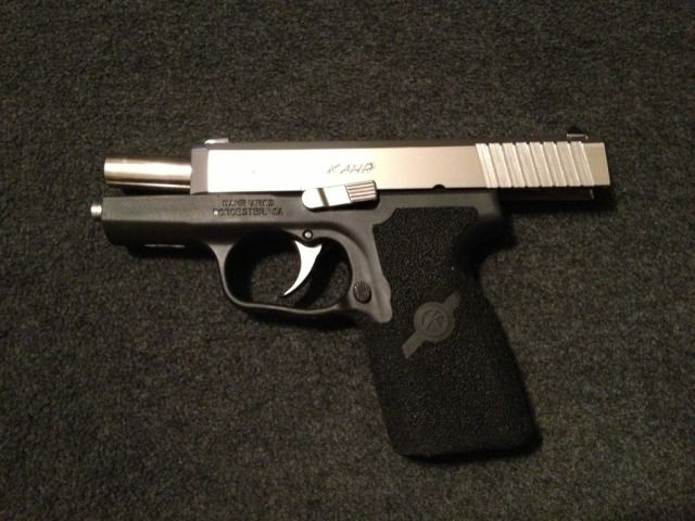

    I have seen a couple of threads and pics of some shiny Kahrs and who doesn't want a shiny gun? I Lready polished the trigger components, but I have now polished the barrel for smooth slide action. And this afternoon I went to work om the slide. I polished the sides to a nice high gloss, but left the fop more of a matte to keep any glare interfering with the sights. Its so pretty! I then decided to polish up the magazines to help them drop free even more efficiently. And I finished it all up with a polished guide rod.
    On the polish work, I used Mother's Mag and Aluminum compound. Good stuff!
    I did about the same thing to my CM9 one weekend. I went from 400, to 1000, to 1500, to 2000 grit paper then mag polish on the sides of the slide. It was just a bit too shiny for me. Actually it was almost mirror like and showed every finger print. So the next weekend I went back to 400 grit all one direction the entire length of the slide. which gives it the finish of brushed aluminum. I like it better that way. It looks about like yours does.

      I like how the slide is kind of a brushed shiny. I think that would be a good finish if you get a scratch because you can just "re-brush" it.

          Yeah, I didn't want a mirror finish. I was kind of going for the same look the Ruger SR9 has. Polished smooth on the sides and matte on top. I'm happy with it. I just wish I could find the night sights now. I can't find them anywhere.

                    Looks Great AdamSean. Did you do everything by hand or was a wheel involved as well?

                      Wow, nice work. I am going to do my barrel, what was your process if you don't mind sharing? Did you use a dremel? That was my plan.

                            I used a Dremel on the barrel with a polishing felt pad. On the slide I used the Mother's Mag and Aluminum compound and a cotton cloth.
