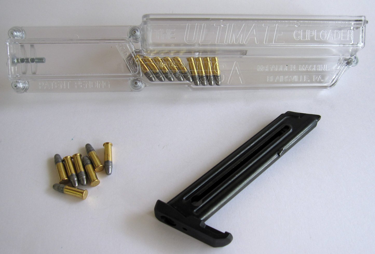

                    Now I just need to see what Wifey needs on her G19. I think the big white dots will work for her. I can't wait to try the big dots at the range. I ordered a McFadden Ultimate Ultimate Clip Loader for my Ruger MK3 22/45 mags... holds 50 rounds and loads the mags in 3 seconds... $24 off Amazon Prime, delivered in two days. I would like to have that before I go to the range with the .22.
