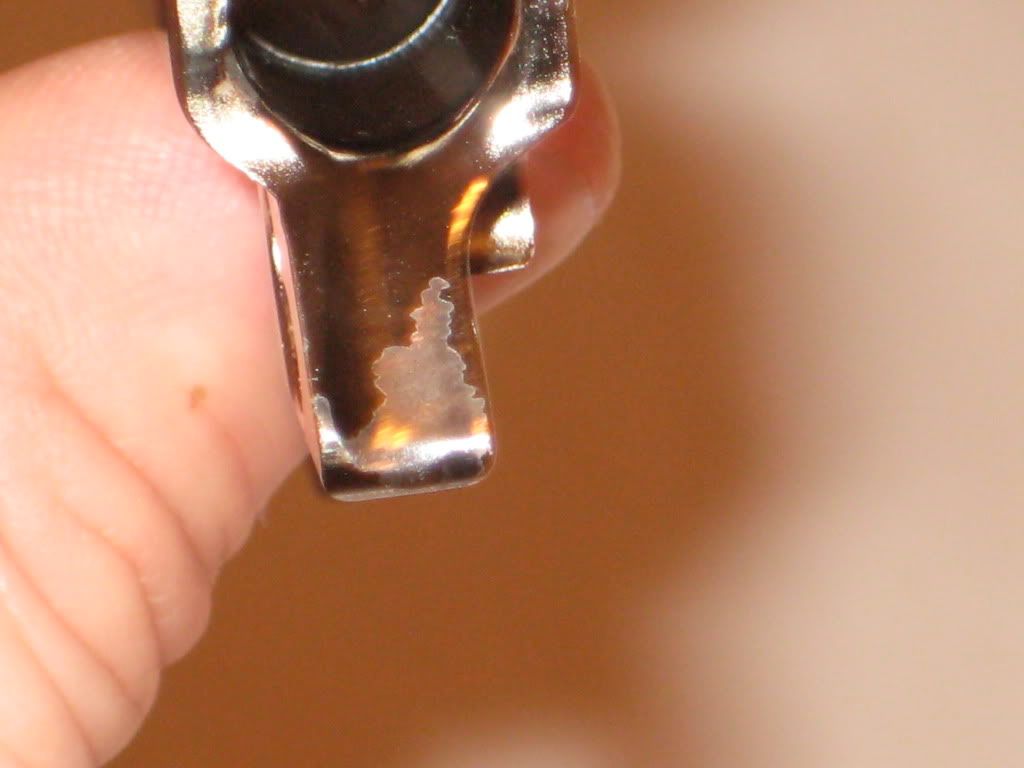

    I have about 700 rounds thru my PM9. In the middle of the feed ramp it looks like the plating is coming off. It dosn't looked scratched, it looks like chrome peeling off. I never had any problems with the gun, it just seams odd.

        Thanks for the reply. I'm not sure that my chamber and feed ramp are chrome or plated. My feed ramp came with a mirror finish. In the middle of the feed ramp where the bullets hit its white like the finish is getting knocked off. I will post some pics tonight once my daughters sleeping.

                Added pics.
                  I
                  Originally posted by Singlestack_9mm View Post
                  Added pics.
                  think I would call kahr and talk to them about this, you might be able to even send them this photo via email to their tech dept for all to see. I don't think that barrel is right, whether it is working correctly or not. Sure looks like some type of chrome plating to me. Guess I was wrong on that part to.
                  Keep us informed if you will. My bet is that they will send yuo a new barrel and you willnot hav eto send your old one in either.
                    That sure looks like it's plated. Did you buy your PM9 new from a dealer... that's the original barrel?
                      I am a Tooling Engineer by profession and can confirm that your photo it is definitely some type of plating, but I cannot tell what type from the photo. I should be stripped and re-plated or it will now only continue to get worst. I would contact Kahr this should be covered under warranty.

                        It's the original barrel and I bought it new from a local dealer, IA serial #. I plan to call Kahr Monday.
                          your gun is one of the latest made so kahr will stand behind it, would be nice if they could see the photo u posted here as it would save time etc. they will repalce the barrel. I do think you can send this photo via email to kahr service also.
                          Keep up posted...
                            Kahr had me ship the barrel to them. They wouldn't send me one without inspecting my barrel. They said they would ship out the new barrel the same day. I was trying to ask the guy about the plating, but my 3 year daughter was up my butt, making it very difficult to have a conversation with the tech. I figure when I get the new barrel I'll hand rack the gun a couple hundred times and put about 200 rounds thru to make sure it all good.

                              i believe that they are nickel plating the newer ones. i had an mk9 that i bought a couple of years ago and it was polished. i got another mk9 in july and it is definitely plated. it looks like the bore is also plated.
