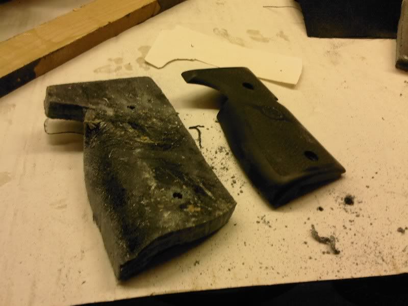

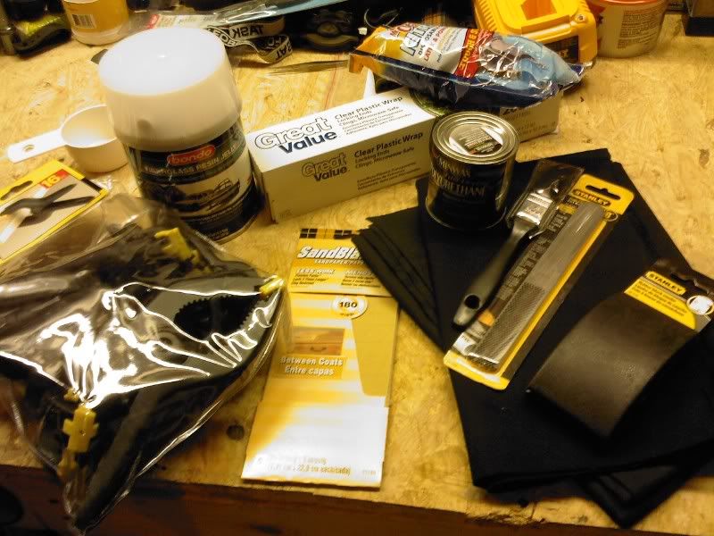

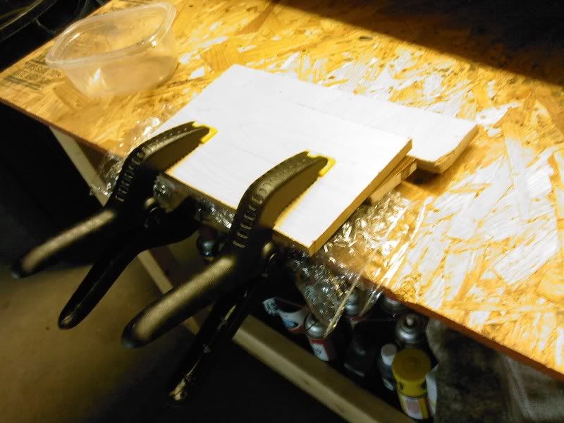

    After reading a how-to on making some grips using layers of denim and fiberglass resin I decided to give it a try. I bought my denim from Hobby Lobby and got 2/3 yd in black and 2/3 yd in dark gray. In the light at my house the dark gray looks more like navy, which is also okay with me. I couldn't find any fiberglass resin at HL so I went to AutoZone and picked up some there by Bondo called fiberglass resin "jelly" which turns out isn't what I was looking for. So I ended up having to go back out to ACE and picked up just some fiberglass resin (no jelly, the jelly isn't clear). I had to pick up a few other assorted materials for the project like a file, a sanding block, chainsaw sharpener, latex gloves, saran wrap..thus far I have about $65 in this project. I have plenty of fabric and enough resin to make 5 sets of grips.

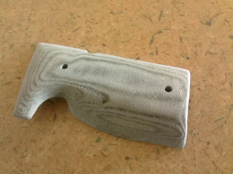

    This is my first attempt at making grips of any kind. The how-to was on a 1911 forum, which has grips that are much simpler than those on a kahr. I have worked on the project somewhere around 6 hours so far. Most of that time has been spent filing and sanding on them to get them thinner and into shape. I went by the how-to's suggestion of using 15 layers to be approx 1/4". Mine came out 5/16" which is way too thick for me, therefore a lot of time has been spent sanding layers off. Next time I will probably go with 12 layers and see how it does. I say next time because I'm not anticipating this first set to be usable, but more of a practice set (yeah, 6 hours already on the practice). I can already tell on the back side where the grips meet at the top of the frame I'm going to have a small gap. Also, I haven't got to the point of working on where the 2 sides meet in the back.
    Here's the how-to I went by:
    http://forums.1911forum.com/showthread.php?t=263495

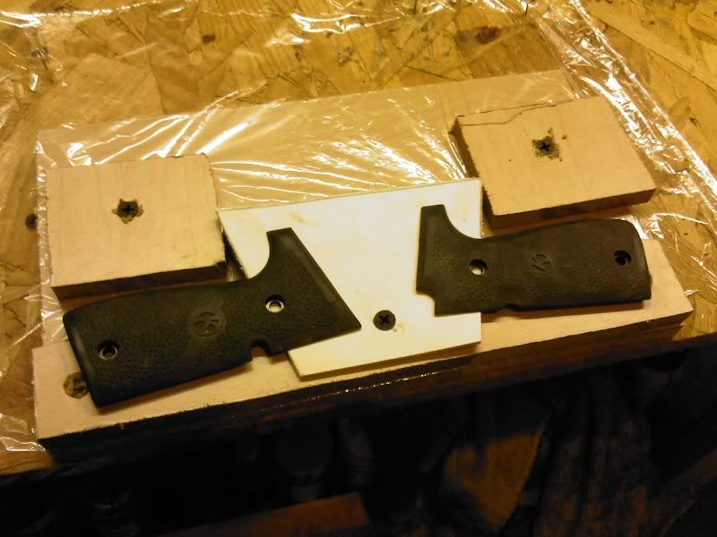

    With his it is just using 2 flat boards to press the grips. Since the Kahr's grips wrap around the back I had to put a curve into it. Also, the grips will darken after applying the polyurethane in the end. Well, here's pics of my progress so far. Probably won't get to work on them much more until later in the weekend.

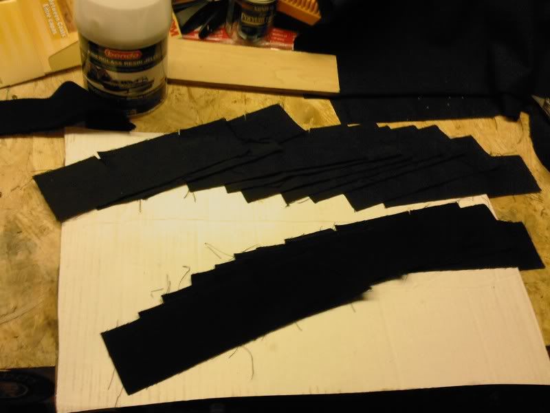

    Here's my layers of fabric I cut out, then alternated laying them down.

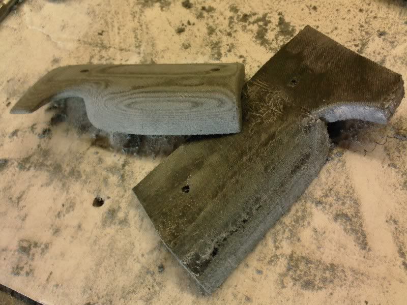

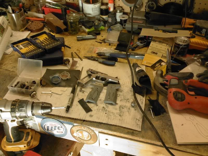

    My work area is a huge mess now..with denim dust everywhere.
    K40 Stainless (traded to) -> PM9 (sold to fund) -> Ruger GP100 Blue 4"...now Kahrless
      Also, I've found that a band saw would be a really nice thing to have, but the jigsaw worked pretty well for me to cut the general shape. A dremel seems to be the most effective on this combo of resin and denim, but mine is cordless, in other words mostly useless except for 10 minutes out of every hour I get to use it before its dead. So, now i'm looking at getting a corded dremel to finish.

            Well Mr. B I'm aware of the very real possibility that my K40 may be wearing it's rubber grips for the remainder of its life . I started this project to give me something to do until I start work on the 28. I am hoping I can come out with a nice set of grips though. As for the inside of the grips, I went by the factory grips and tried to get it close then just kept putting it to it and see what needed trimmed more until it fit into place. The grip that I have the most work done on is fitted pretty good at the front of the panel, but I haven't grooved the rear of the panel. I was going to wait until I have the other grip caught up and see how hard it is to fit them to each other before I put a groove in it for the rear of the frame.
