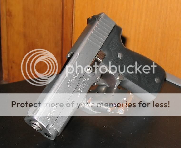

                        Brasso and some soft cleaning cloths will clean it up. No tools needed. Scotch tape around the sights will protect them.
                          I did the flat areas of my old K40 which I stupidly sold years ago. On the hunt for another now.
                          Anywho, I used 5-6 different sandpaper grits taped to a glass pane. A 2x4 block was used as a guide to keep the slide level as I ran it back and forth over the sandpaper. Mask off what you don't want polished. Never rub in circles but front to back. Circles swirls look awful. Go slow and take you time. last step was a washcloth with a little abrasive car wax to bring out the shine. Took a few nights while watching TV to complete. I thought it was fun.
                          Before....
                          After....
                          EDIT: Forgot the add that I used wet sandpaper and used water liberally to wash out the gunk as I polished the slide. Clean and oil VERY well after you are done.
