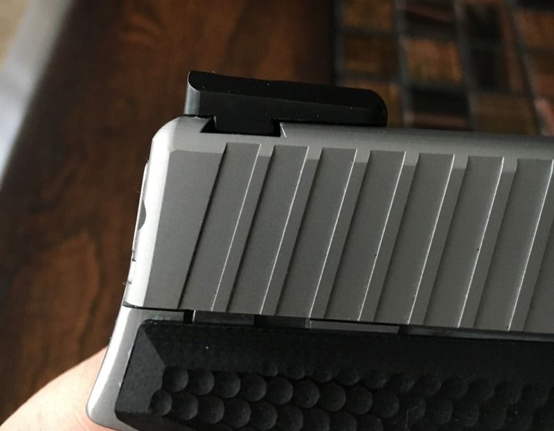

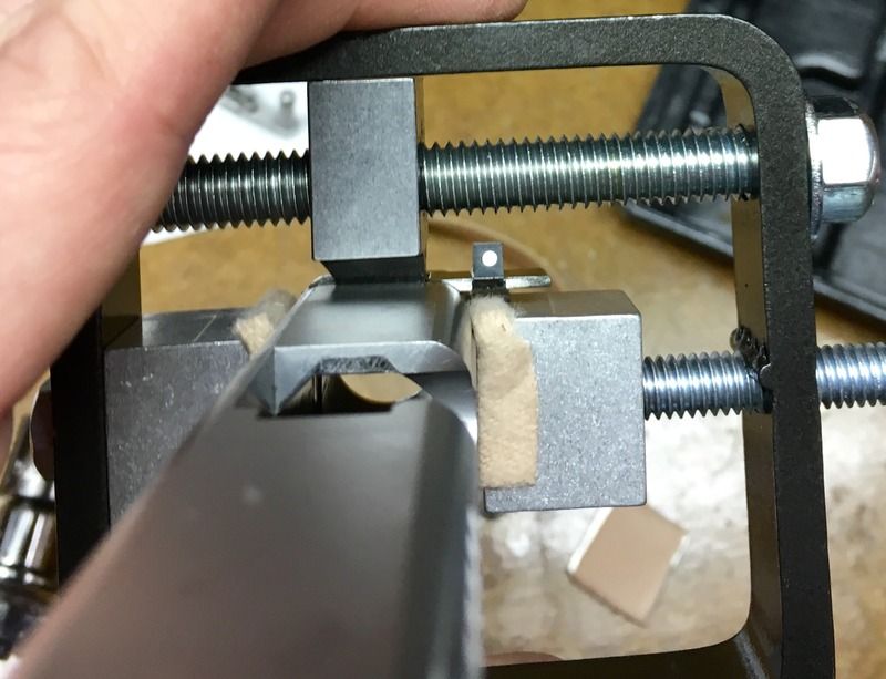

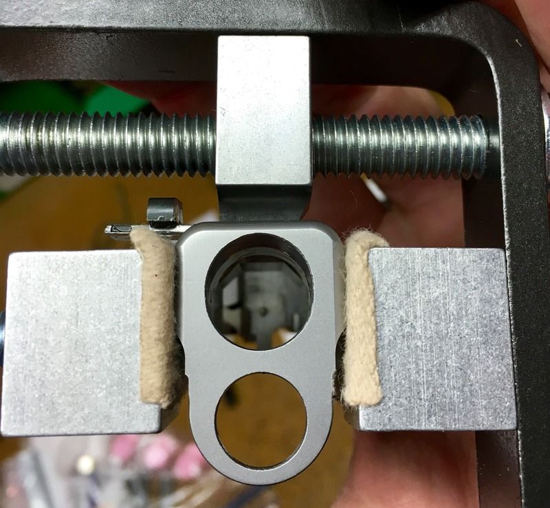

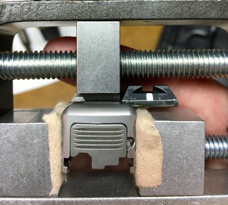

    Well my wife was nice enough to give me my sights yesterday. They are TruGlo TFX sights for Kahrs. I have to admit that I was a bit nervous about changing the sights myself, although I have a lot of experience installing pistol sights, because of the online posts saying how freaking impossible Kahr sights are to change. Well that is hogwash. It was an absolute breeze. I followed instructions to remove the stock sights from left to right (toward ejection port) and reverse for instillation of the new sights. BTW, I did all of this with my cheapo Amazon sight pusher that cost me all of $30 when I had gotten it a year or so ago. I cannot say enough good things about this cheap sight pusher. I mean it cost me the amount of a single sight installation and it has now put on many sights on many different pistols for myself, family and friends. Love it.
    Here's some pics of the process as I've gone. I like pictures in posts so I try to do the same for others when I post. Enjoy.

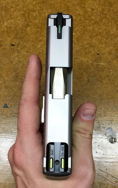

    Removal of the old sights:
    Off with the rear
    Off with the front:

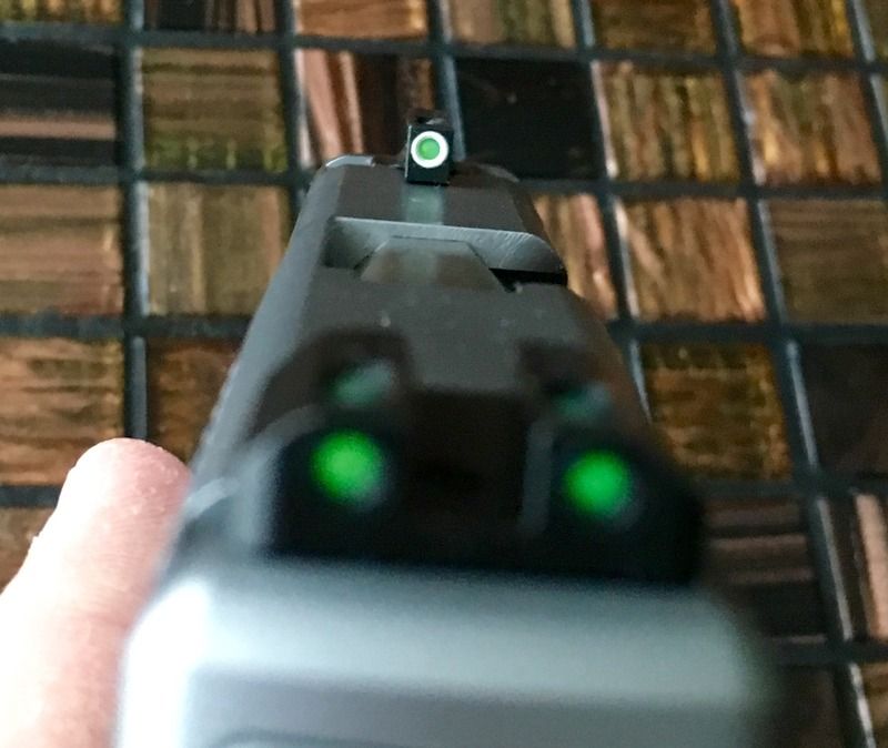

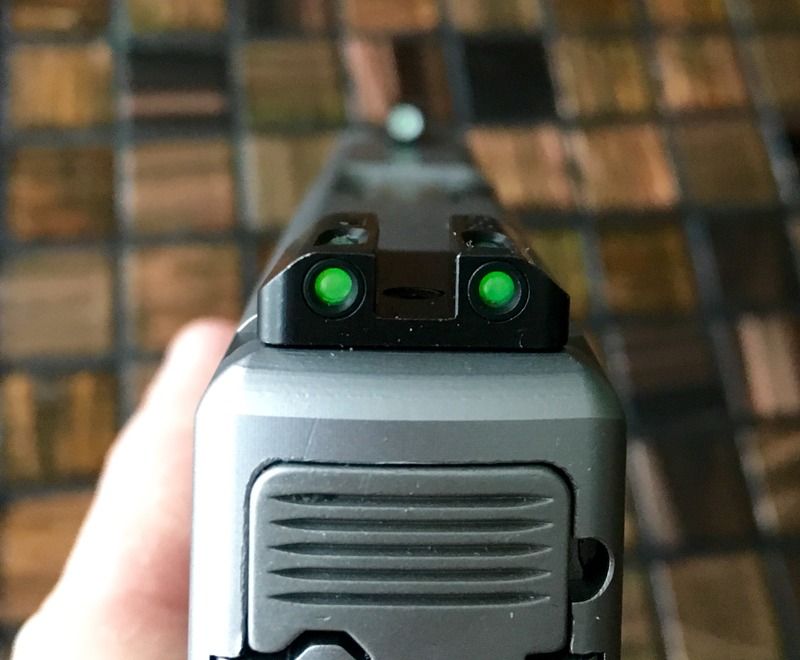

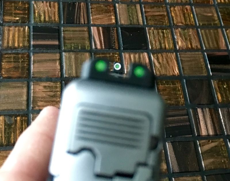

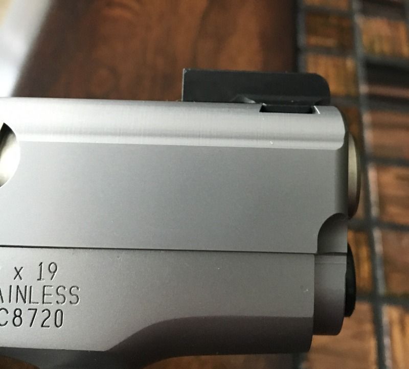

    New sights installed (verified center using calipers):

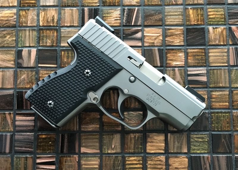

    Glamour shots:

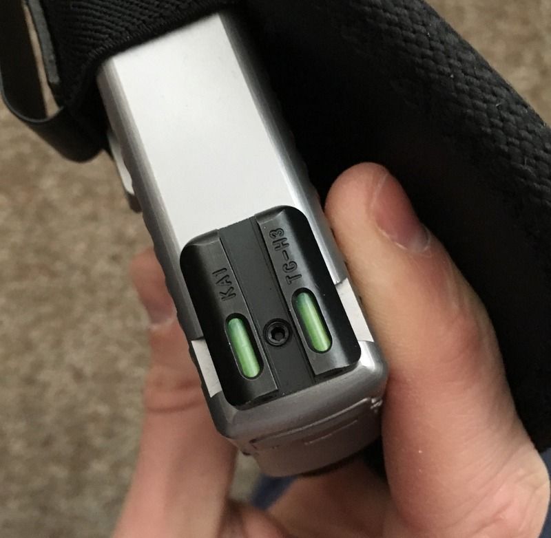

    close up of set-screw they have on the rear sight:
