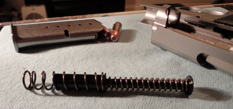

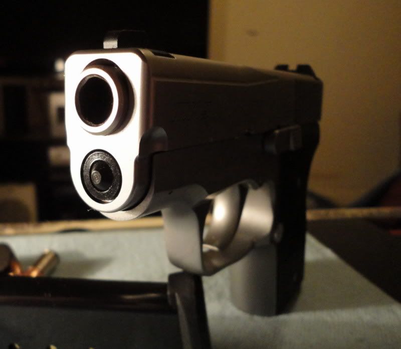

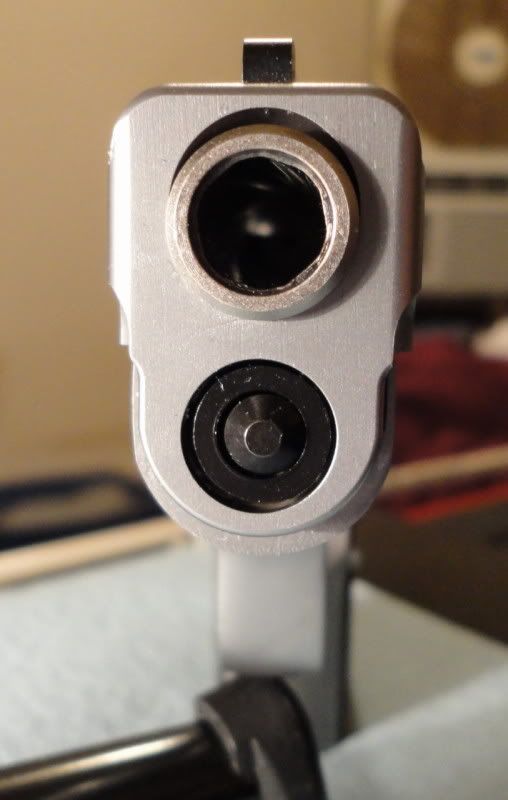

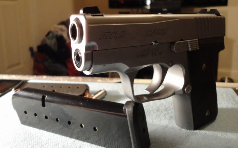

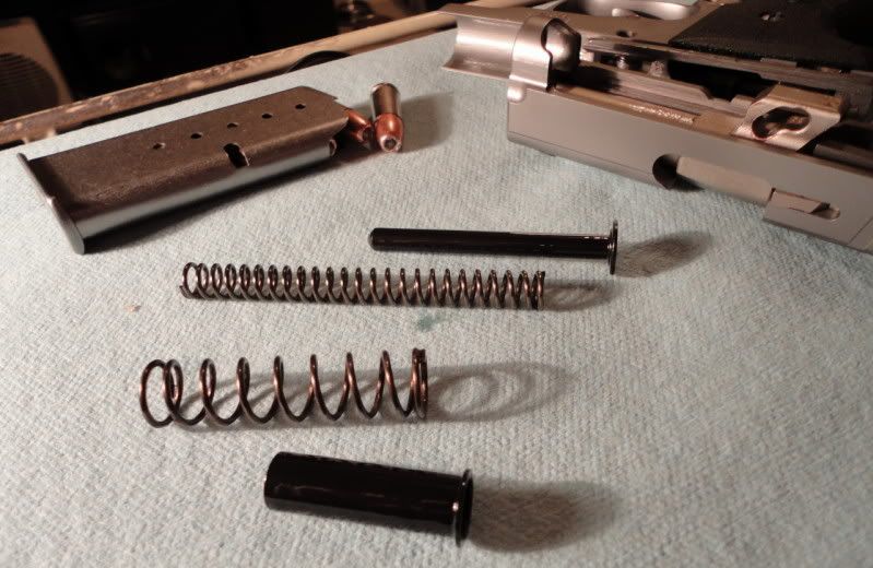

After my last outing and coming to the conclusion i needed a heavier recoil spring in order for my MK9 to digest hot +P loads i purchased the Wolff steel setup. Its a combo pack of guide rod and springs for $35 +shipping.

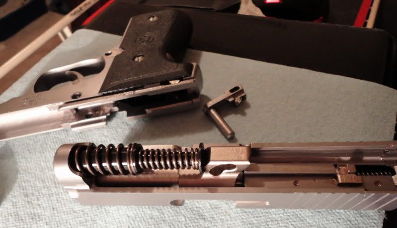

Picked up an heavier set for my RIA Officers CS 1911 as it has the exact issue also. Both being new guns and having the same issue at the same time and jams that are identical made it kind of easy to diagnose both having a timing issue with +P loads.
I still need to function test it, But its a really nice heavy duty setup.
I ordered the 22.5lb springs in the combo and it comes with a standard power striker spring which i found no reason to replace,yet anyhow.

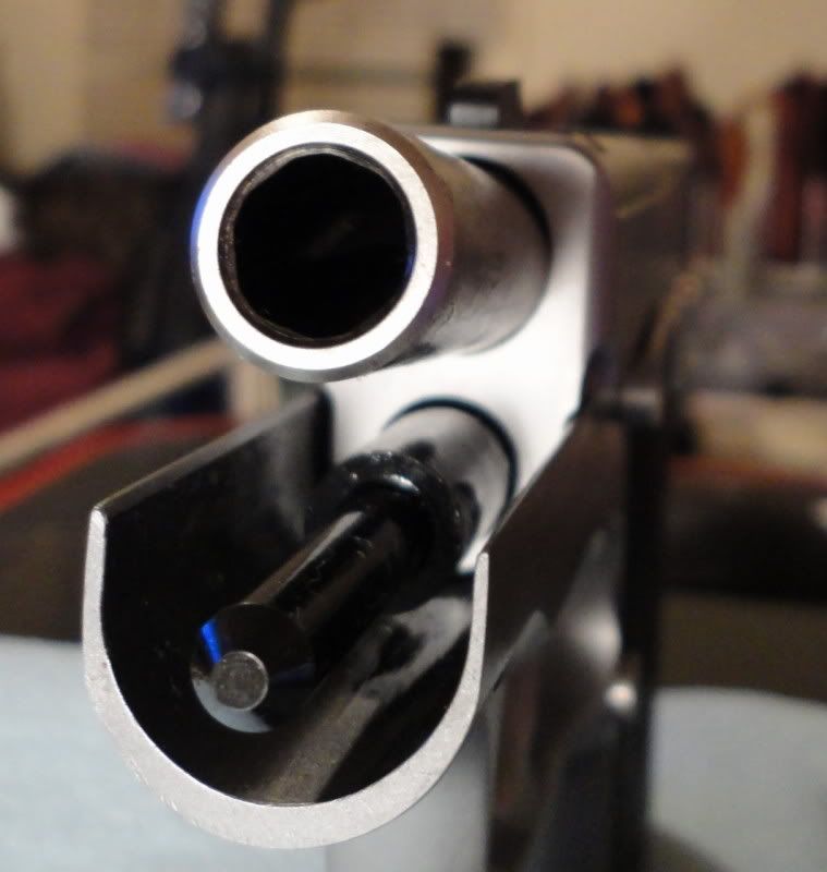

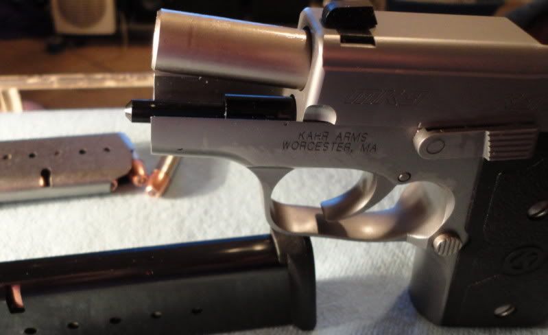

The package is pretty much what you expect from Wolff, Nice fitting and no flaws. I was concerned about the all Black rod system but the OEM captive setup is black also. I liked the Kahr stainless but the price of the Guide rod+shipping and then upgraded springs and shipping its almost twice the cost. Bedair doesn't list an MK setup or PM so that wasn't an option.
Plus i wasn't so sure about the captive setup and how long it would take for me to bugger it up, Im bad at stripping screws and destroying the heads of screws.

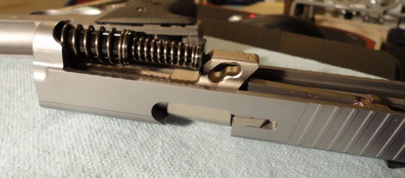

This extra power setup is a bit of a muscle job getting those springs compressed and into place in the slide. But it doesn't hang up or give you issues, You just need some strength with getting it in there.
Tons of pics so you see exactly what you get, Well i left what you get out but i took pics of what you "need" to see.
