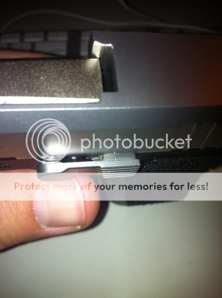

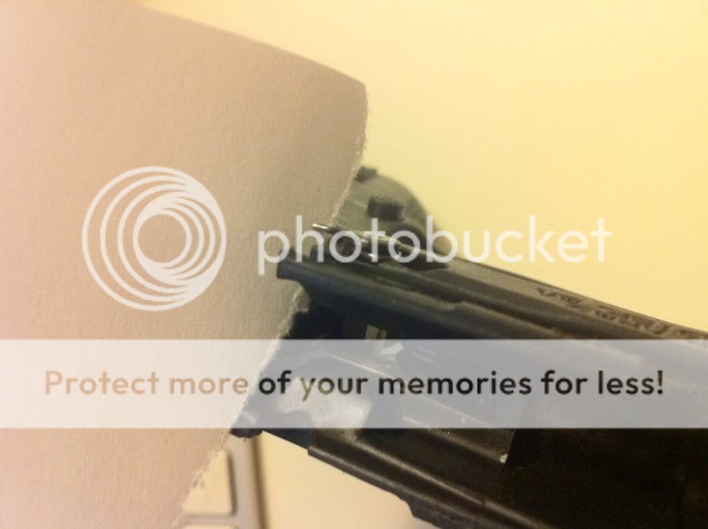

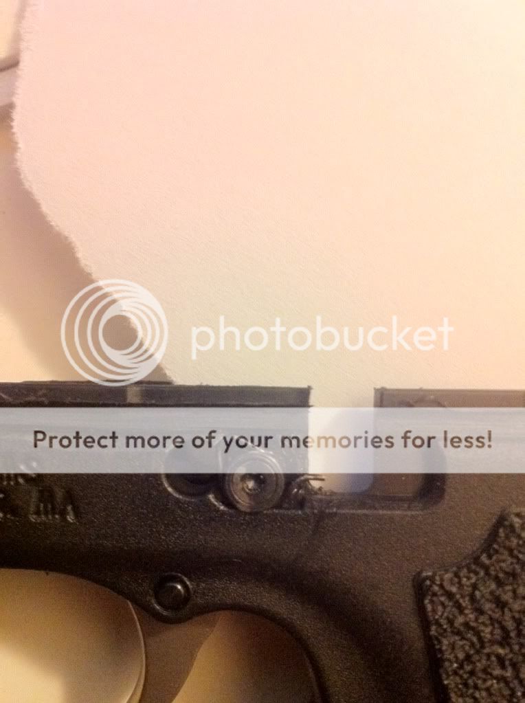

I picked up my new CW40 last week and in the process of showing me how to properly dismantle the thing, the dealer bent the slide stop spring. He bent it back into place and I took it to the range. I put about 50 rounds through it with no problems at all. The next day I put 200 rounds through it with no problems.
I took it home and cleaned it and reassembled it. I took it to the range again and the slide would lock back with rounds in the chamber on the 3rd shot. then it would run fine. then it would lock back on the second shot. then run fine for the rest of the mag. Then it would lock back on the first shot and then run fine.
I took it home and it looked like the spring was bent slightly UP from 90 degrees. I bent it down and reassembled the gun confirming the spring sat in the notch in the slide stop. Took it back to the range and ran 200 rounds through it no problem.
I called Kahr and they recommend replacing the spring. They told me it was incredibly easy to install but I am no gunsmith and I plan on using this as my carry gun. The spring looks EXACTLY like it should in the manual, the slide stop lever has good tension (it wiggled a little prior to the malfunctions) and seems to be working fine. Should I attempt to replace it? I dont know of many gunsmiths in my area.
The Kahr agent also said that my malfunction sounded "weird" and it may be my thumb accidentally pushing up on the slide stop during recoil. I am inclined to agree since my slide only locked back once per mag, it did NOT lock back after every round.
any help would be appreciated!
