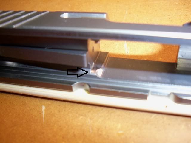

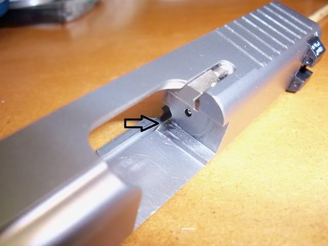

            OK, here are some pictures showing the area I am referring to. Sorry about my cheap camera. I used a needle file to smooth the angled surface and round the sharp corner, silicon carbide paper glued to a wooden stick for rough polish and Flitz on a wooden stick for final polish. Put tape on the breach face to protect it.
              Great pics. That really helps the explanation.

                That area on my PM40 appears to be fairly smooth after more than two thousand rounds. The polishing action of the break-in process may have helped.
                You might examine the corresponding area of the extractor claw. I ended up slightly rounding and polishing the lower edge of the extractor that is roughly opposite the area of the slide that you polished, with a noticeable improvement in the smoothness of feeding rounds when cycling by hand.
                Depending on how nicely machined your extractor is, it may not be an issue on your gun, but mine was very sharp edged before I polished it.
