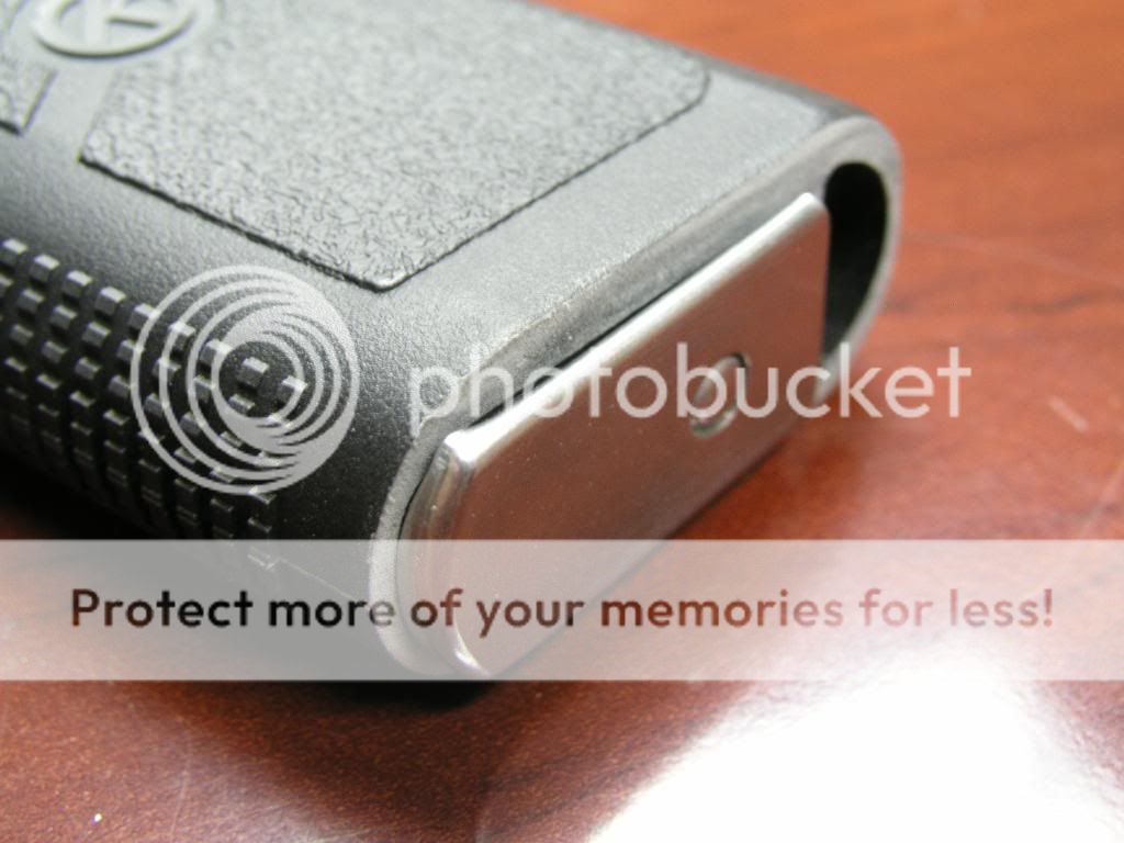

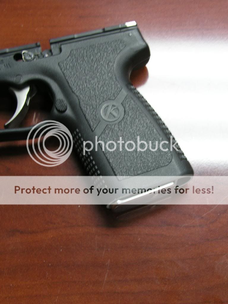

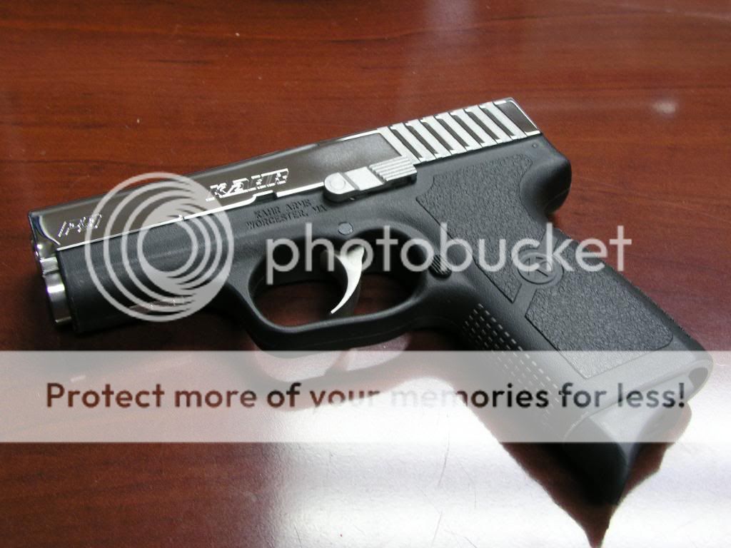

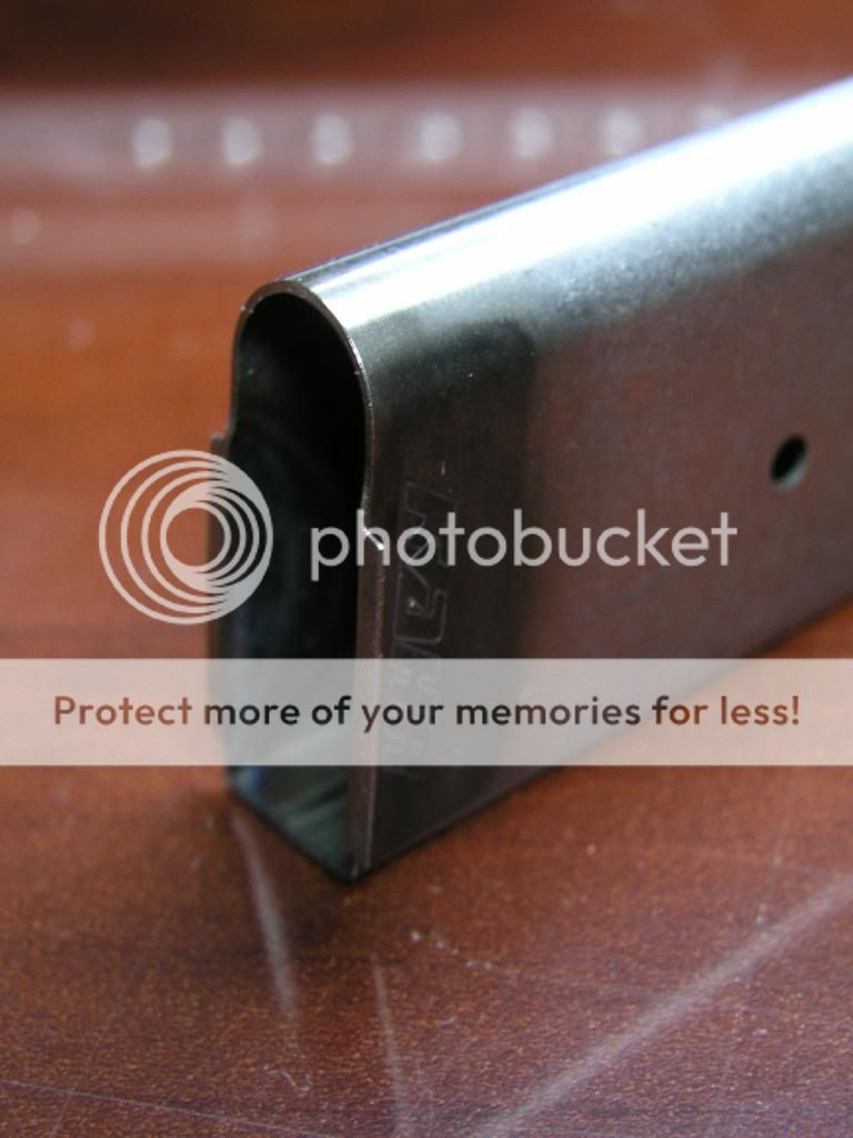

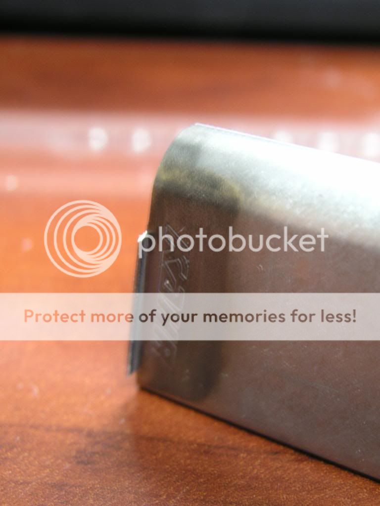

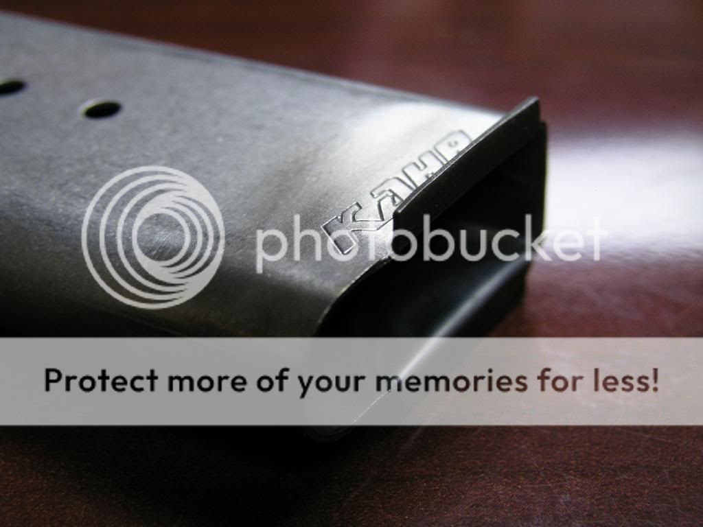

        As a matter a fact I've already pulled the trigger on what color duracoat the frame will get (pic below). And I also shortened up the 7 rd mag I had so that it now sits flush with the base. Took about 3mm out of the bottom and bent new tabs accordingly. She still holds a full 7 just looks a lot nicer.

        Mag
        What would you charge to modify magazines? I would love to have 2 flush fit CW/P magazines. Have you considered selling these?

        • I actually have considered selling shorten mags, but I wouldn't be comfortable selling them until I've tested the hell out of the couple I've made. There were a couple details I didn't mention before. Now the 7rd mag won't take a full 7 rounds with a 7rd spring (too much spring tension). However with a 6rd mag spring installed it handles 7rds no sweat and so far shoots perfect. I have been looking into buying a couple lots of kahr mags, but haven't pulled the trigger yet. Unfortunately I flattened out the bottom of my P9, so I can't really use that as reference to make a perfect mag for stock frames. My friend has a CW9 so I guess I will have to borrow his. I could make a jig block for mass production, I would have to start a thread to see what kind of demand there is.
          Edit: it does take 7 rounds in the clip with a 7rd spring but it won't snap into the frame with the slide closed (too much tension), but it will with the slide open. So the 7+1 is not an option with the 7rd mag spring.

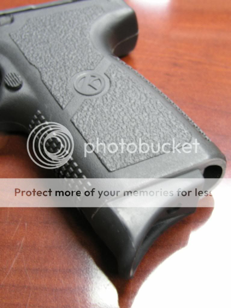

          • The only thing I would consider doing (as I am for mine) is adding some small cutouts to the poly to allow for the magazine to be grasped. Something like this.

            • Had an issue with the shorten mag today at the range. Of the 10 or so clips I put through my P9 on 2 of them it failed to lock open when empty; obviously lack of mag spring length. I need to find a spring in between a 6rd spring and a 7rd mag spring. I think I might order a 6rd spring from wolf, they claim 5% extra power maybe that will do the trick.
              • Can you take a 7rd spring and remover one coil?
                ..... I carry a small gun to compensate for my huge pecker.
                • yes, remover one coil!
