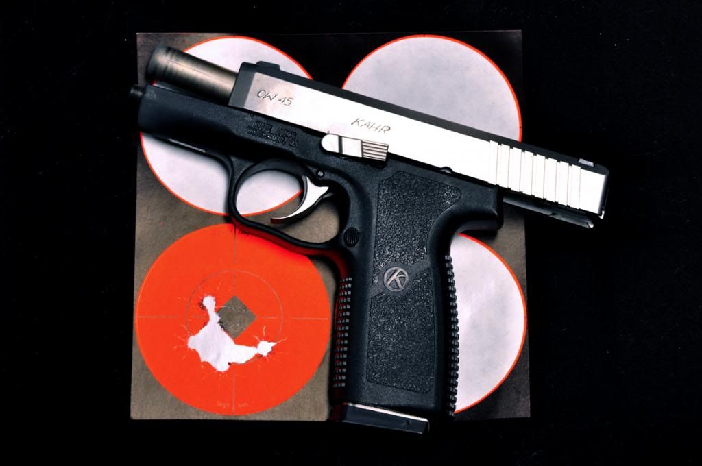

    It's 20deg here in central WI today and there's a foot of fresh snow at the range from the last week, so my brother and I jumped in the Jeep and got back there anyways We took 4 or 5 of our carry guns and my new CW45 for her maiden voyage. Put 100rds of Remington redbox 230gr ball through it and couldn't be more pleased. Had a couple failures to chamber in the first few mags, one FTE about 2 mags later and it was smooth running for the rest of the 100.
    I went through the checklists in the New Member sticky section and addressed everything pertaining to my copy. We're just shooting at 7yds to start with while it breaks in and I couldnt be happier with the accuracy of this little guy. I immediately felt good about this purchase when the very first shot I took with it fell dead center in the 3/4 inch orange bullseye on the center mass circle of the bad guy silhouette. The full 6 shot group only had about a two inch spread, not bad for a brand new gun with unfamiliar sights and trigger. We took turns with it while we rotated between the guns we brought and each of us agree it is a fantastic gun to shoot. It points naturally, recoil is very mild and it is very controllable for it's size. Im 6'5 225lbs and my brother is a couple inches shorter, we both have big hands and love how well the gun handles and feels for its size. Im used to shooting .357 snubby's with full house loads and my .454 Casull so recoil is never an issue for me. We had a KelTec PF9 with us today and shooting back to back the CW45 is much more tame than that. It's a pleasure to shoot.
    I wanted to try some of my 185gr hp mild target loads I run in my 1911 after I burned through the two boxes of factory ball ammo I brought. I loaded the mag with 5 of them and hit the slide release only to have it jam up tighter than heck about 1/8" short of full battery. I guess everything about the extremely tight chambers is true lol, my Lee die's size the completed rounds while they're extracted from the crimp die and they do NOT go in. After I managed to get that round out of the chamber I noticed the side cover on the polymer frame was not flush anymore. Something pushed it from inside when I tried to chamber that round and pulled the threads out of the frame for that little torx screw. The repair is drying as I type this, I hope I can get them to run in it after it's broken in fully.
    Anyways, by the end of the session I was shooting groups that were one ragged hole from 7yds while standing. I cant wait to shoot it at 15 and 25yds once it starts to warm up a bit. The great accuracy I had read about in so many reviews was one of the main factors in purchasing it, so far it has not disappointed. I wont feel one bit of regret sending the PT145 Mil. Pro that it is replacing down the road, it was a great gun, just wasnt quite accurate enough for my tastes. The CW45 seems like the best of both worlds, accurate enough to bring with and be fun on range days and small enough to carry comfortably. So far it has done everything I hoped it would, I cant ask for much more!!

      I couldn't see any way that a round not chambering could cause that to happen either. I field stripped it to test fit a different one in the chamber with the barrel out of the gun after I got the first one out. It was then that I noticed the side cover protruding about half the thickness of the plastic. I didnt remember it looking like that when I cleaned it last night before the first trip to the range. Perhaps it worked its way out while we were shooting it prior to that and I just didnt notice. Im just glad the side cover is such a tight interference fit to the frame, had it fallen off I would've had a difficult time locating it and the tiny screw in the snow.
      The trigger is the best of its kind that I've shot, thats for sure. I find it quite easy to take up about 3/4 of the pull quickly and slowly squeeze the last 1/4 for a shorter feel. I run my loads at 1.230 and find they function perfect in every .45 I've ran them through.

              Thanks for the replies and kind words everyone! Perhaps I'll have to try a shorter OAL on some loads just for this gun and see if I can get it to work. Oh well, if I have to buy ball ammo just for this gun for a while I will just have more brass to load for my 1911. We'll give it another try in a couple hundred more rounds, otherwise maybe a chamber reaming would remedy the problem.
              I also want to say thank you to everyone for all the great tips and tutorials here, I found two or three problems with my gun before I even fired it for the first time because of reading through the new members section. My mag follower needed a shave and I had to create the guide rod spring recess in the slide. Its great to have a wealth of other peoples knowledge/experience at your fingertips.
