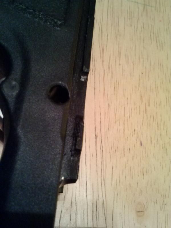

    Howdy everyone, this is my first post to this site. I just acquired a CW45 in trade and was able to shoot it today. No malfunctions other than I believe my thumb was hitting the slide stop, so I'll have to work on that. It sticks out more than other handguns I have had in the past.

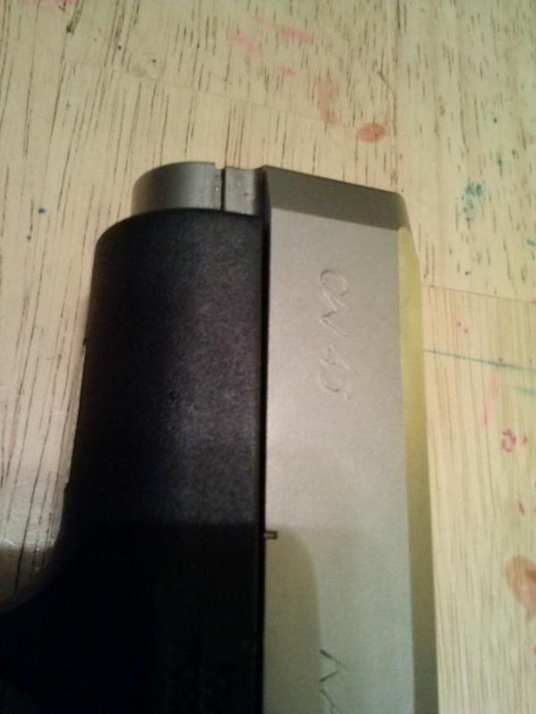

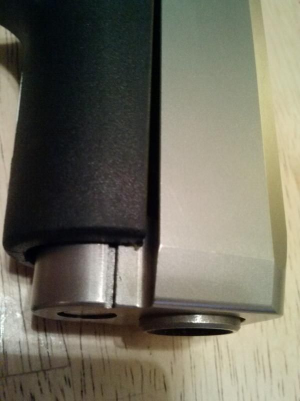

    However, the big issue that I have is that after I was done firing, I grabbed the rear of the slide to lock it back and it wouldn't budge. Not at all. But if I grab it at the front of the slide then it would go back fine. Disassembled it and saw that the front right frame (the short section) has the lower part of it shaved off making it thinner from top to bottom. I put the slide back on and noticed that when trying to lock the slide back from the rear of the slide, it applied downward force at the rear of the slide and upward force at the front so it would, I guess, catch part of that frame rail and not slide back. I also then noticed a larger gap between the bottom of the slide and the frame at the front of the slide.
    The frame rail
    Gap on right side of slide
    Normal gap on left side
    I will be calling Kahr on Monday to see what they say. I am not very optimistic as this is part of the entire frame. What does everyone think?
    Welcome to the forums!
    The frame rail in your first photo is there to help guide the slide onto the metal rails at the rear of the frame and in the dust cover (http://glocktalk.com/forums/showthread.php?t=765313)
    We see some initial wear on the poly rails as the gun is used and it usually ceases after a certain point. The poly rails can also show wear/damage from installing the slide with less than optimal alignment.
    As to why you can't retract the slide from the rear and the uneven gaps at the front of the frame, I'd suggest checking the fit and condition of the metal rails in the dust cover. They should look/fit in similar to these (that's a CW45 on the right):
      Well there was a piece of the poly rail that actually came off. I understand normal wear and perhaps my picture and original description were poorly done but I don't believe this is normal. I did say shaving off but it was more like a small chunk that is now gone.
      As for the gap issue and the lower metal rails, maybe there is an issue there as well because the gap between slide and frame is much more noticeable on the right side than on the left. So I will call Kahr and talk to them about it to see what they say. And the issue about not being able to pull the slide back from the rear portion of the slide started immediately after the piece of the rail came off. Do the Kahr customer service people look at these forums? It would be nice to direct them to these images while describing it over the phone.

          Oh, and that gap at the front is normal, my CW9, P9, CW40 and the 2 CW45's I had all had that same gap at the front area of the slide.
            Your picture and explanation were done well enough. If you don't believe it's normal, then by all means contact Kahr (http://www.kahr.com/contact.asp). You can ask them to view this thread or they may have you email the photos to them.
            FWIW, here's a photo of the same "rail" on my CW45 (it has quite a few rounds through it):
            The damage you see to it was most likely caused by me being a little sloppy when removing the slide. This has had no effect on the operation of the pistol.
              Ok so it seeming like this is normal. However, does anyone have any ideas on why when I try to rack the slide by holding the rear of the slide (pulling) it will not go back, but when I try from the front of the slide (pushing) it goes back fine? Something has to be catching somewhere.
