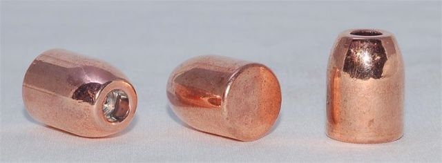

                          For break-in I used 230gr plated hollowpoints over 5.3gr WW231. Worked great! Had no issues with the Kahr magazine, and I found a MagPack 7rd Officers magazine on ebay that needed only the typical mod on the follower to not hang on the magazine catch and it works really well now.
                          http://store.iqmetals.com/hsmplatedhandgunbullets.aspx

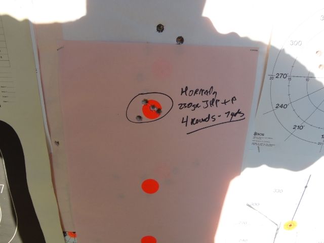

                          Quite impressed with groups right out of the box:
                          This CW45 really took a liking to Hornady's 230gr +P hollowpoint!

                            Good shooting. I can do the same with my CW45 with the full length grip. I struggle a little more with my CM9 .

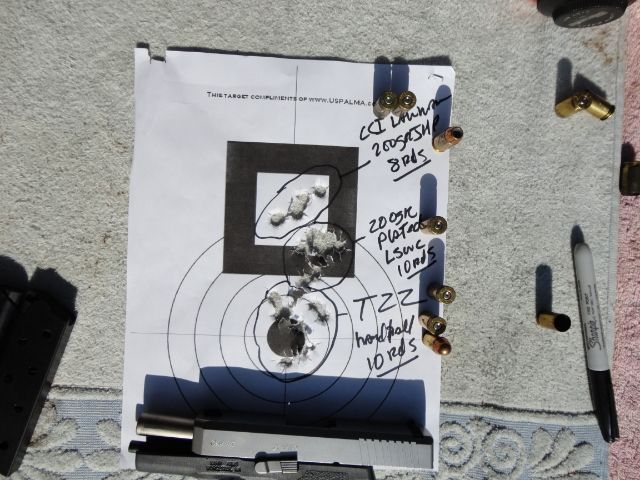

                              I recently bought some X-Treme Bullets 200-gr. plated SWC's. They look good and are quite reasonably priced. Shipping is included. Should be loading up the first test batches in a week or so.
                                Hey Bill, I had some issues with Berry's SWC's in my CW45. The bottom of the ejecting case seems to hook the step in the SWC bullet profile. When it causes a little damage the new round can have difficulty chambering. It could be my load, and I have only tried one powder so far. I think you may find a thread on this (and brass damage) in the reloading section.
