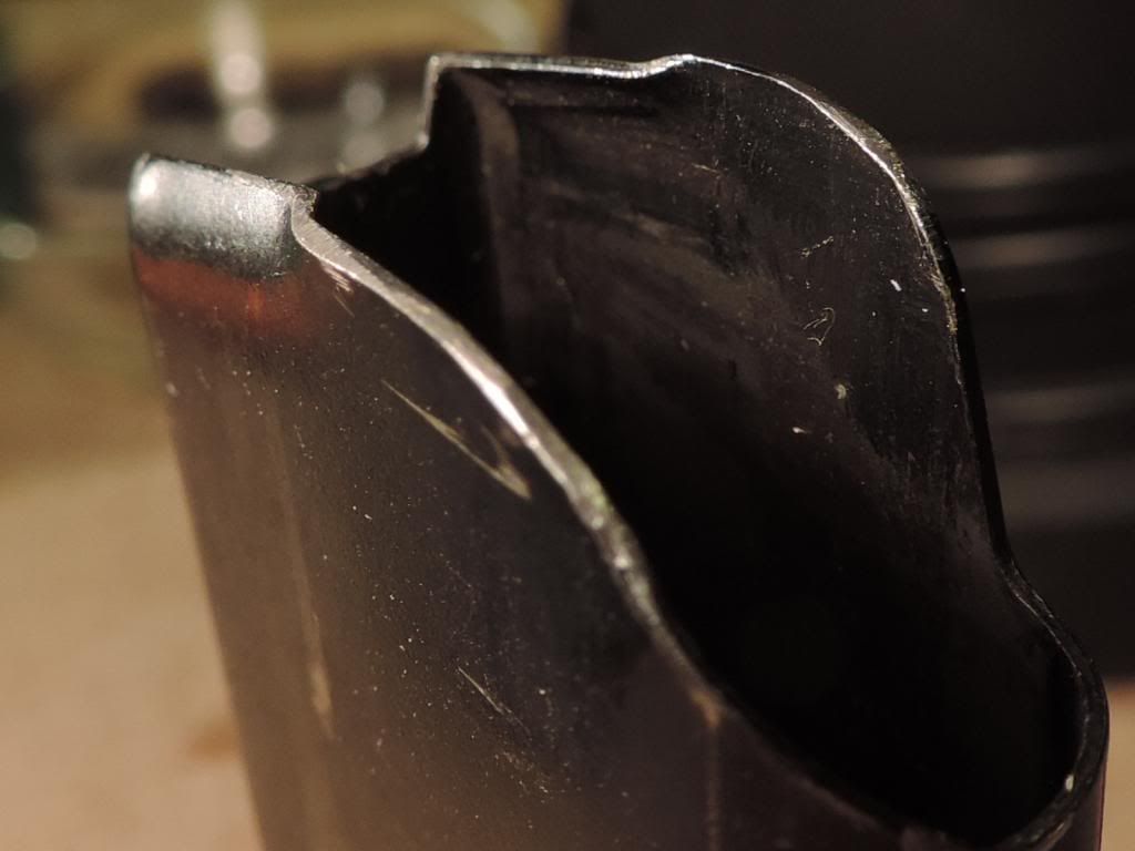

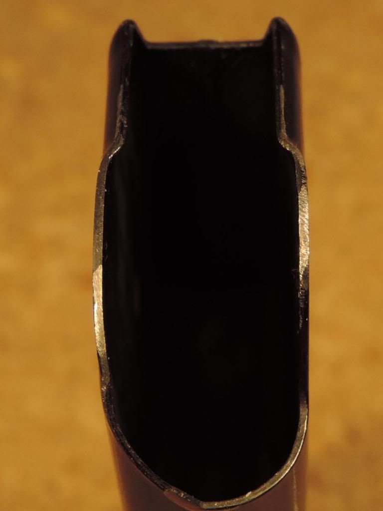

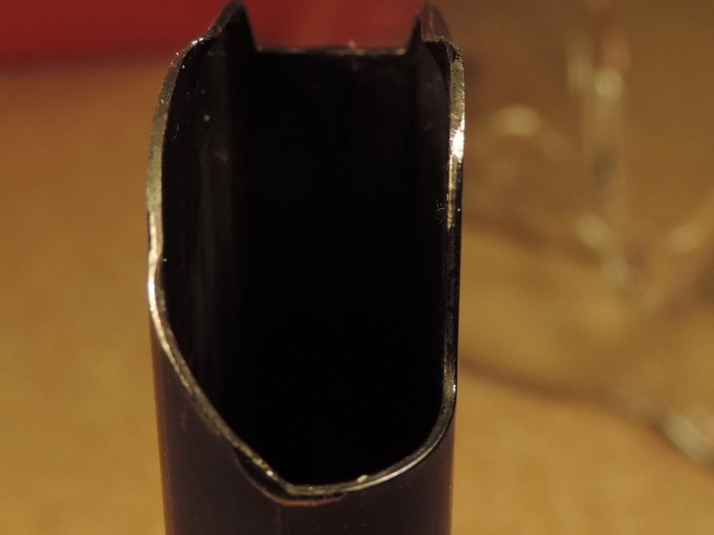

                Okay, here is the mag from a couple different angles. I see your recommendation Ikeo, obviously can't check that out in the garage If anyone sees any other problems with the mag, let me know.

                          It appears to me that your mag modification needs to be "smoothed up".
                          Use a fine file, or sandpaper, to deburr the edges of the mag. You don't want to remove metal, just "dull" the edges. Sometimes even a new mag needs to be deburred.
                          Try it, it can't hurt!
