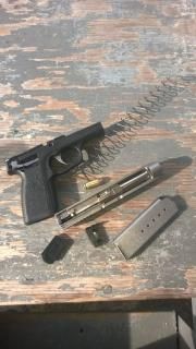

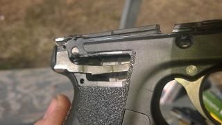

            Pics of the gun, casing and injury would all be very helpful in this investigation... Please post.

                            Yup, thats pretty much was a knocked out sideplate looks like when pressure from a seperation on a defective round hits the innards.
