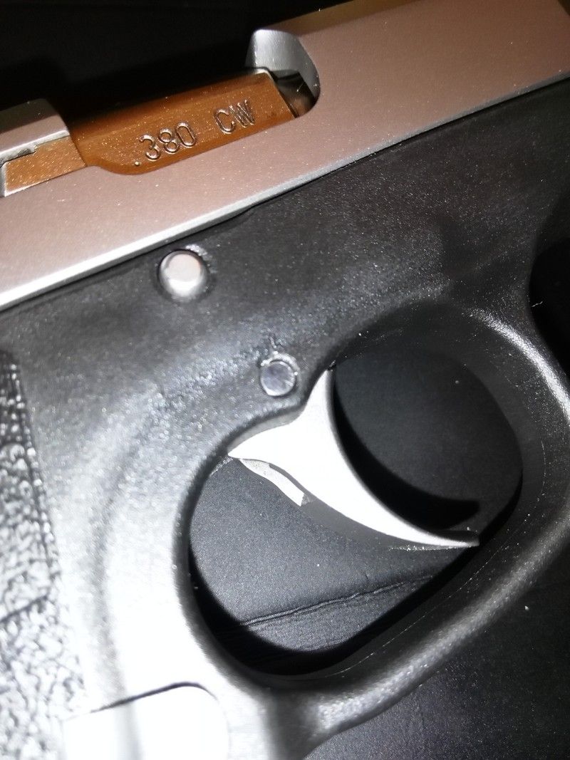

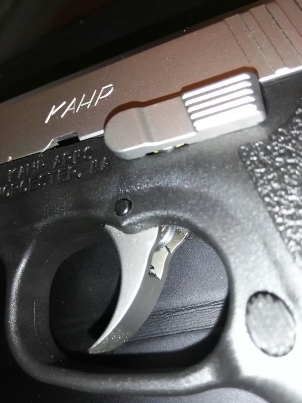

    The second mod deals with the trigger hinge pin walking out during firing. I just filed down the lip on the right side of the pin until it was the same diameter as the rest of the pin. After that I was able to insert the pin until I could feel it fully engage the tiny pin on opposite side of the frame that holds it in place. Evidently, the trigger pin wasn't long enough from the factory as it never engaged that tiny pin before. Now it's solidly in there. Hope these mods are helpful to someone else.

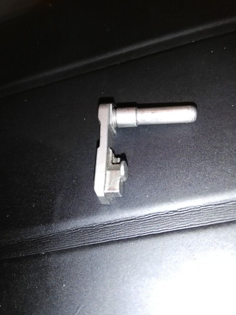

    I also performed the same slide stop modification on my CW380 (serial number RJ38XX). I originally had multiple failures to feed and premature slide locks. I ordered a replacement machined P380 slide stop (not the MIM, metal-injected-molded) from Kahr for $24.20 and filed it as above. It is now very reliable with the CW380 slide and barrel. I used an EdgeCraft Diamond Knife Sharpener (bought at Gander Mountain) as a file. The gun now functions like a Ruger LCP in regards to lack of last round hold-open.
    I filed and beveled the top edge of the slide stop for better comfort in releasing slide. The slide stop "pin" which inserts into the frame was also polished.

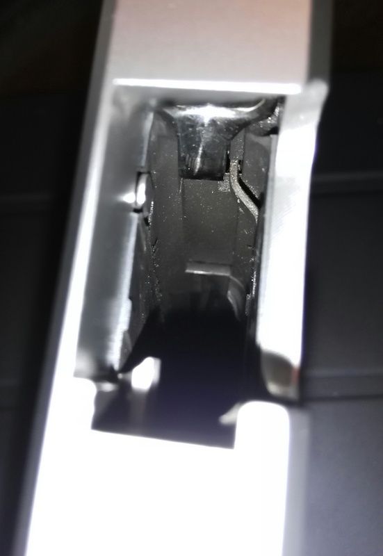

    I polished the inside of the CW380 barrel chamber (mostly the upper portion) with a Dremel device for smooth feeding. Feed ramp was already highly polished. I used the included Dremel white cylinder-like polishing "wheel", which I ran/sanded on a file/sandpaper to resize the attachment to fit the chamber.
    I minimally deburred the rough thin edge along the right posterior margin of the CW380 barrel hood with a small fine hobby file (from Lowes) and wet dry sand paper. I have had several CW380 barrels with this defect, likely left from the manufacturer's process. Avoid removing too much metal along the hood margins as this could lead to a more loose fit with the slide.

                      "Have you had any issues with the trigger hinge pin?"
                      I have not had any problems with this pin. In regards to the trigger pivot pin, I would try to replace your pin with a replacement pin from Kahr. If your pin continues to back out while shooting, you will need to send the frame back to Kahr for service. In some cases, the frame is out of spec and needs to be replaced with a new frame. This unfortunately will result in a transfer fee.
                        Won't be necessary, it's locked in there good now.
                          I have multiple CW380 pistols. I tried the usual greater than 200 round break in. I continued to have multiple premature slide locks and failures to feed.
                          I ordered multiple P380 machined slide locks and continued to have premature slide locks and failures to feed, even with adequate lubrication and frequent chamber cleaning.
                          I partially grinded the portion of the slide stop that interfaces with the magazine tab, still allowing for the last round hold-open. Same problems. I tried grinding varying degrees off the slide stop, tried different magazines, but still experienced multiple premature slide locks and failure to feed.
                          I polished the chamber. Same problems, less frequent. Slide lock spring and screw both looked intact and correctly installed. I did not attempt to adjust frame slide lock spring and screw.
                          I finally achieved 100% reliability for greater than 200 rounds by grinding the slide stop as posted above. I then tried replacing the now broken in gun (with 100% reliability with over 500 rounds) with a new unmodified replacement machined slide stop. Same problems, less frequent. I had about 1 malfunction (premature slide lock or failure to feed) in about 100 rounds. I tried different frames. Same problems.

                              My trigger pin seemed to be the same....I have about 800 rounds thru it, and felt the rim of the pin on my trigger finger when holding the gun at ready.
                              I used a nylon hammer and tapped it back in, but it doesn't seem to be long enough to fully go into the hole on the left side. I was thinking about ordering a new pin, but reluctant to pay $20 shipping on a 2-3 dollar part.
