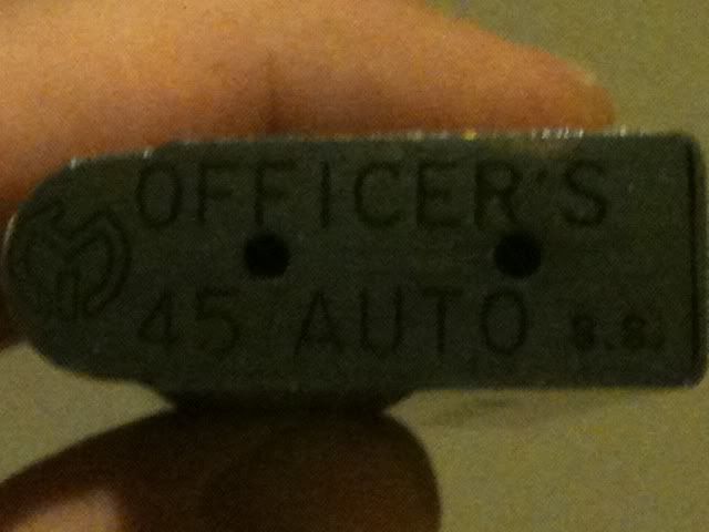

I got this mag at Midway last week so it looks like Metalform has changed the base plates recently.

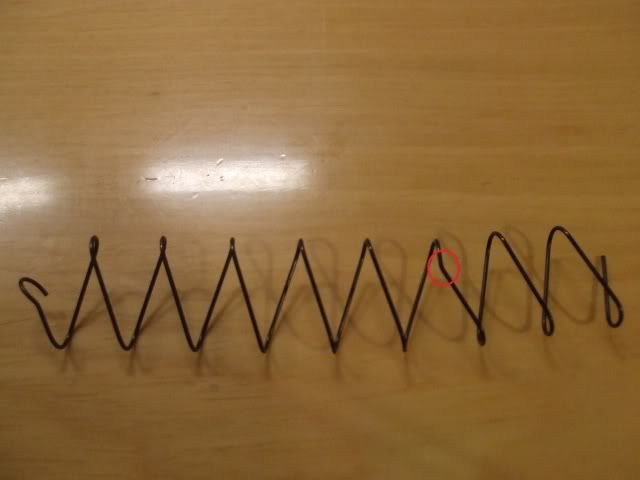

I'm not sure about the quality of the Metalform mags. I know STI ships them with their 9mm Spartans, but this is the spring that came out of my 45 mag. I've never seen one this twisted and the extra bend was a bit of a surprise.

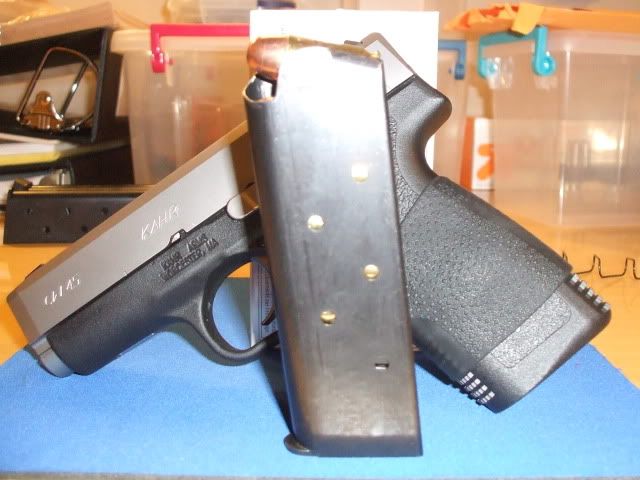

It turned out well and even installing the Kahr follower was easy after viewing the video. Thanks very much for all the details. I'm still going to try a non-Kahr follower at some point to see if I can make a 7 rounder out of this, but for now I'm ready to start testing.

I think your observation about the Metalform magazines is spot on.
I was just at their website and it seems that they have dropped the folded over style magazine base. The spring that came in the magazine I used from them would not have been my first choice if making magazines myself, but it did perform adequately in the brief time that I used it. However, the tube seems to be of excellent quality.

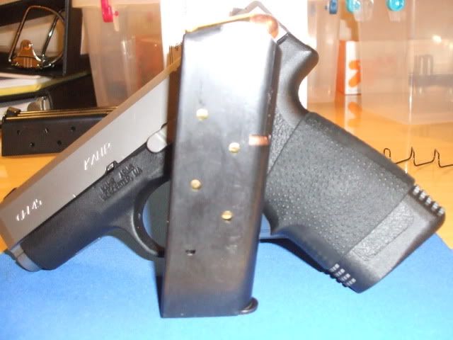

Great original and follow-up "how I did it" posts and pictures. I have to admit that before I saw your post I hadn't even considered this, but once I saw your photos I knew I had to do this. Just finished my first stainless steel Metalform mag and it functions perfectly on the bench. Now it's off to the range tomorrow to give it a real test.
This flush fit mag is going to improve my carry comfort and concealability. Thanks for the great posts!

I finally got my Wilson mag rebuild kit and my Presto blue pen this week so I finished up my project and gave it a good shake down at the range today. I'm incredibly happy to report flawless performance from the magazine through a box of target hardball and half a box of Fed Expanding FMJ 200 grain +P. I knew both of these ammos worked 100% in the gun so I didn't want to introduce any additional variables.
I'll be making a few more of these soon. Even with gutting the Metalform magazine and buying the rebuild kit, it's still just $23 to make one and you get the benefits of an extra round and last round slide lock back in a much more flush fitting magazine.
Thanks for all the tips and tricks along the way. The only caution I will throw into the mix is to make sure you get the rebuild kit pictured since it's specifically for the Metalform magazine.
