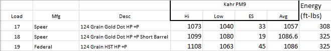

    The Short Barrel ammo comes from Speer in their Gold Dot line. The only varience in the Golden Saber ammo is some are bonded and some are not. Based on my testing of the standard pressure 124 grain GS last weekend, I'm not convinced that it's worth the effort or additional cost to chase the bonded version for general defensive purposes.
    The short barrel Gold Dots do run about 50 fps faster than the standard gold dots from my PM9. All gold dots are bonded so you will not see a bonded variation on the gold dot. Personally, I wouldn't bother chasing the short barrel version of the GD line because the standard version is cheaper in boxes of 50 and that allows for more practice with carry ammo.
      the short barrel GD sure sound sto me like a very good ADD HYPE by speer. 50fps more would not be worth a penneymore than the standard GD defense rounds. Just sayin The corbon dpx round with the barens all copper bullet is pretty hard to beat IMO.. Not cheap, butneither is life.
        When I said 50fps, I was actually being kind. In my testing, it's about 30 fps faster. In my house, HST rules the roost. I'd use it for everything if I could find sufficient quantities in 9mm, .40, and .45 acp. That said, there's nothing at all bad about Golden Saber or Gold Dot. My preference for HST comes only from slightly faster velocities and the petals don't flatten back as much as the GS. Corbon may also be fantastic, but I've never tested any of it.
