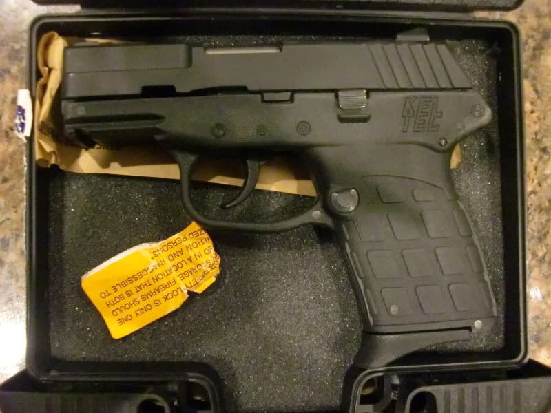

              I have the "tactical matte black" that came out GREAT on my RUGER LCP and Kel tec PF-9. I didn't use the aerosol though b/c I heard that it can come out uneven, so I used my small air brush gun (with a very nice air brush) and put on thin even coats. Came out looking better than stock. Nice smooth black finish, not glossy at all.
              This is one my of pf-9's that I sprayed, I had two, this one i sold b/c I never shot the darn thing.
              I have my LCP that I carry almost daily, and that thing shows no sign of wear with the duracoat. Whereas the factory finish rubbed off within a few weeks of carrying both guns.
