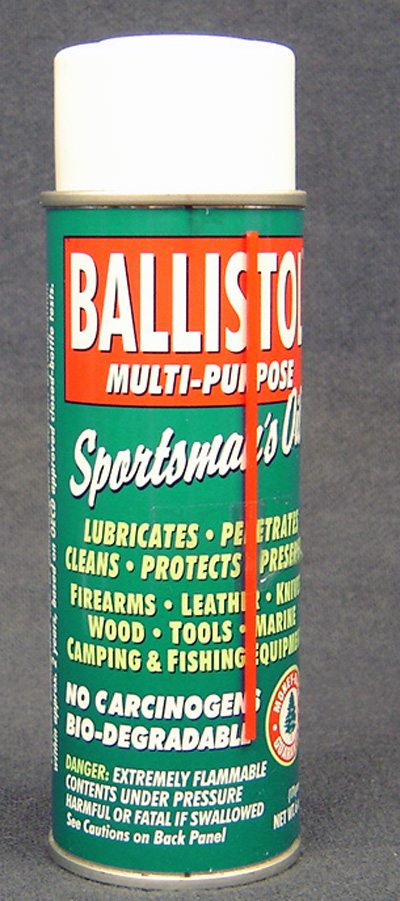

    To clean everything, I used Ballistol. I know...some folks hate it, and i'll probably catch some heat here. But to clean everything i gave the parts a Balli-bath, then wiped everything down excessively to make sure I left no residue on any part. Ran a Qtip with Balli through the striker channel, and pushed a patch-piece through the extractor channel. Again I wiped everything in the striker channel down thoroughly, and ran a piece of a dry patch and about 8 clean Qtips down the striker channel (of course not leaving cotton behind). Clean image:
    I know CLP break free or NC brake cleaner is preferred to spray into the cleaner hole for basic maintenance (obviously wouldn't use Ballistol for that). Some folks say to use alcohol, others say not to. I tend to use Ballistol for everything related to cleaning my firearms. So a question for the group is, if you use Ballistol to clean all the parts and the striker channel, AND make sure to thoroughly wipe everything down, will the issue of 'gunk' associated with lubricants come into play? Obviously I dont think so as I used it, but being a n00b in the Kahr world (and this is my first striker-fired firearm) im curious as to what the group has to say.

    Welcome to the forum. Nothing wrong with Ballistol. It's been used for a long time. I have a can of it myself. Safe and effective stuff.
      Welcome to the forum. Clean is good. It really was dirty before. I would think it would run fine now.
        Good job! No problem with Ballistol at all. Enjoy your gun. I've shot mine out to 50 yards on a good day.

            Thanks all, again being new to Kahr (and striker-fired pistols in general) Im glad to hear that Ballistol is OK for the striker channel - I did a good amount of research and didnt see any advice either way - just to make sure not to gunk it up.
            So as a general rule, it seems that using ballistol in the channel to clean it up is OK during a detail strip - but for spraying it out using the cleaning hole stick to the NC brake cleaner or CLP break free (break free seems preferred overall based on my research).

              As long as you wipe away all sign of oil residue, any cleaner should be fine.

                      Was using Militec-1.
                      But have switched to Ballistol.
                      I love that stuff.
                        I have recentlly discovered Ballistol and love it!
                        I can clean my .357 and not worry about messing up my wood grips......I've used it on leather also-it's some slick stuff.

                              @barth & espresso - YES I love ballistol too, discovered it by watching some Hickock45 videos on youtube (highly recommend!). Only thing i did learn, i think from the Armory Channel also on youtube is not to use it if you have gold plating on your firearm, apparently it removes it. Ballistol on crackers...not sure i'd go there but it does smell a bit like sambuca .
