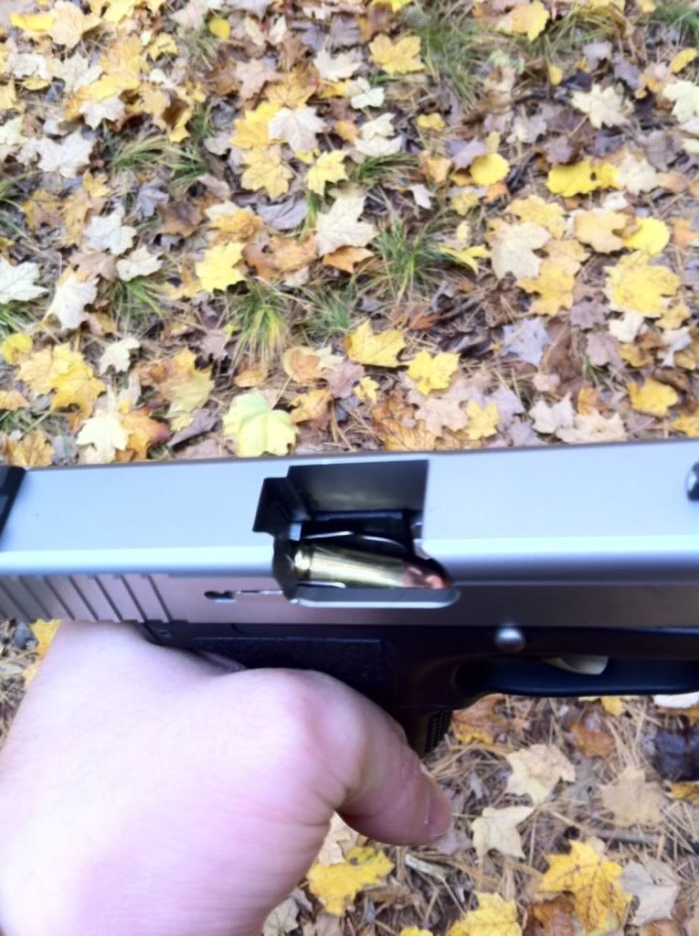

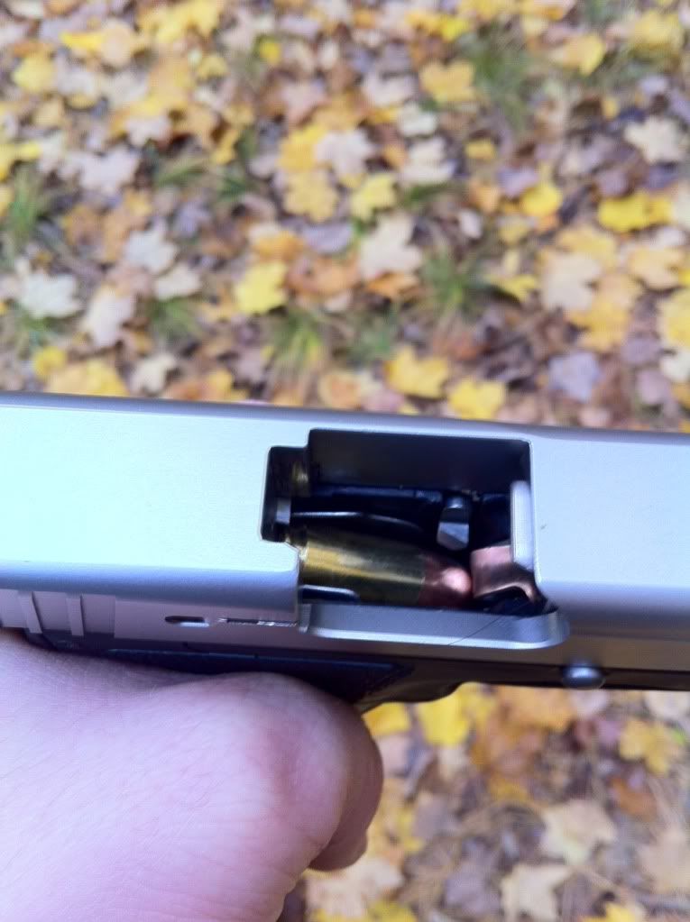

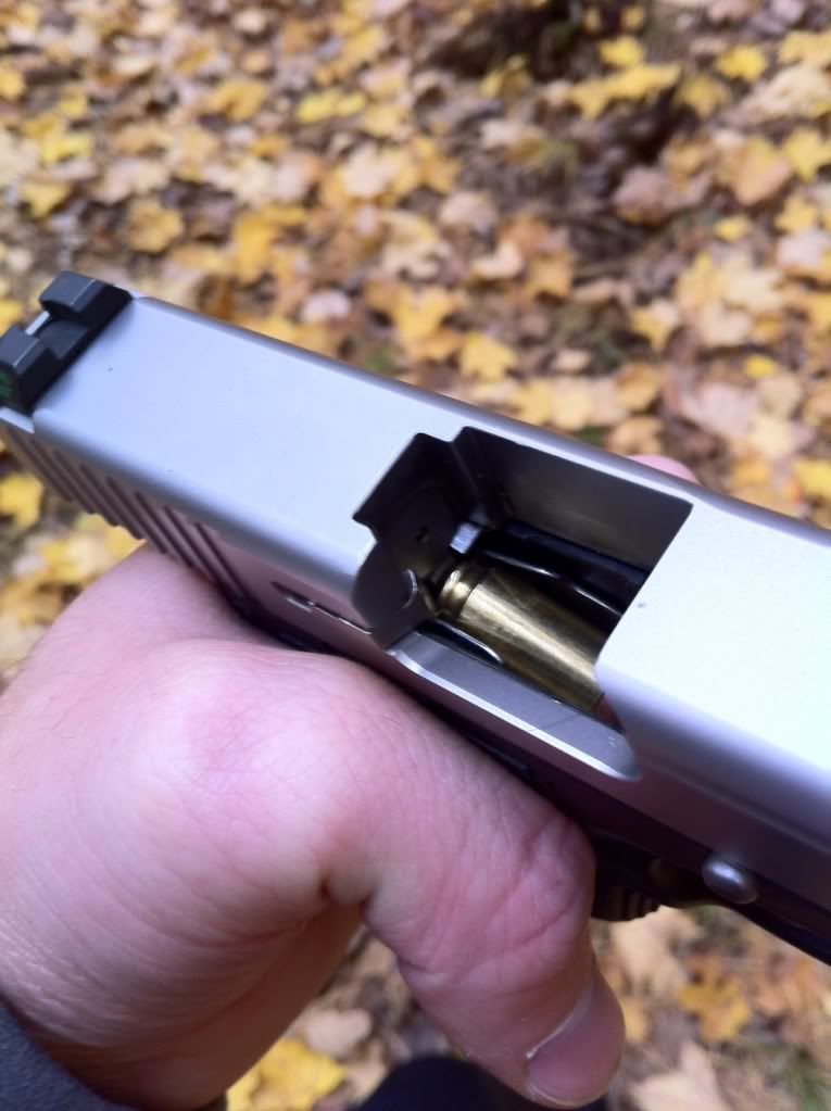

    I've had my PM9 for about a year and a half now and have put at least 700+ rounds through it, so its well broken in, but it still jams on about 66%-75% of the boxes of Winchester White Box that I try to put through it. And its not like its dirty, it'll jam on the first round and I always meticulously clean my guns after shooting them. I'd shoot other stuff if WWB weren't so cheap and still brass cased. I'm just wondering if anyone else's PM or CM jams like mine?

    From your pictures it looks like the front of the bullets are catching below the feed ramp. Maybe it is a magizine problem. Does your gun do this with different magazines? Does it have problems with anyother ammunition?

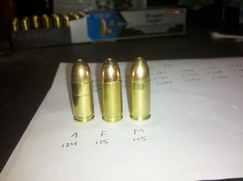

      I took some calipers to these kinds of ammo and grabbed 5 samples of each to compare.
      My CM9 feeds the Federal just fine in my 6rd mags, but extended 7rd mag it jams about 75% of the time just like yours(nosedive UNDER feed ramp). Magtech and Aguila is no problem. I've shot 115gr Aguila as well with no problems at all, but I had none of that on me to compare.
      Magtech was most consistent in OAL from one to another cartridge, Federal was on average the longest, and Aguila was the shortest on average by a good margin.
      I also have about 80 rounds of 115gr JHP Remington which is WAAY shorter overall(haven't measured but it is easily another 0.150" shorter I'd guess... maybe even more) with no issues.
      Here is a pic of the rounds compared... Notice the Federal is the "pointiest" or least rounded of them all? I suspect this may also play into my problems.
