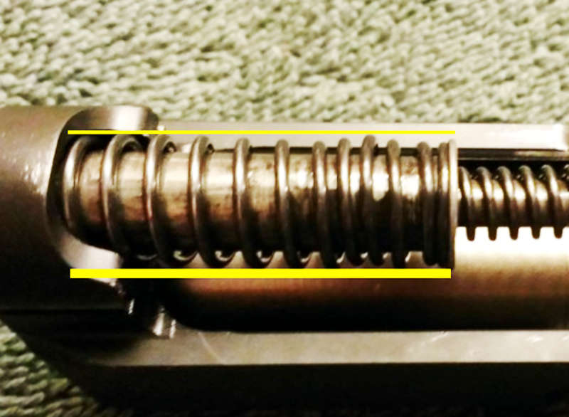

    When field stripping both guns for cleaning, I discovered inconsistencies in the PM40's recoil spring. Didn't notice it the last time, don't remember looking either. Incidentally, it's only when the spring is compressed. Disassembled, it looks normal. SS PM9 also displayed for reference. Anyone ever see such a thing with a new spring? Right out of the box, I could easily tell that the PM40 was much easier to manipulate the slide. During take down, I still hafta fight a little with the PM9 to keep the notches aligned but the PM40 is easy as heck:

    Yeah, the spring in my PM40 has similar variable spacing between coils, with coils near the rear closer together than those in the front section.
    Mine has over a thousand rounds of wear and has never been a problem.
    Not sure what to tell you. I find it a little odd too, but I can't fault my gun's performance in any way and did not even notice it until now.

        Thanks guys. More alarming to me than the spacing is the fact that the spring has felt significantly softer than my PM9 right out of the box. I can't imagine they'd intend that for the PM40.
        I'm hoping a new assembly will be the cure for the failures.
          Re: New PM40 recoil spring issue
          Well, I swapped out the original with a new spring assembly and just the difference in feel is VERY noticeable. The new spring offers much greater resistance. Like I'd said, I thought it very odd that the PM40's slide was significantly easier to work than my PM9's.

              I'm completely psyched to report that I ran a flawless 210 rounds through it today. That makes 740 rounds total in 4 range visits.
              I knew for sure after chambering the very first round. The slide slammed forward with such authority, far greater than it previously had with the original spring.

                    When I look at the pic of the spring in your 40, I see a distorted (bent) spring. It may be rubbing on the guide and/or barrel causing drag.
                      Take a look at the edge of your spring (along the yellow lines that I added). it wobbles
                        This is a timely thread for me. I have a CM40 that is showing the same distortion or twist on its recoil spring. The gun has about 750 rds through it and has failed to reset the sear engagement several times and suffered two light primer strikes in the last 25 rds. I started thinking it maybe a trigger bar/spring problem until this evening when I noticed that as I pulled the trigger slowly the entire slide was moving to the rear approx 1/32 inch. Wondering why the slide was moving I field stripped the gun and found the distorted spring. I am thinking that the distorted spring lightened the spring weight and allowed movement of the slide to the rear which lengthened the striker/sear engagement travel causing the light strikes, etc. Does anyone have any experience with this problem? All ideas are welcome.
                              Absolutely correct, 100percent. I reinstalled the old spring assembly and the inconsistencies appear exactly as in the picture you highlighted.
                              Funny, when disassembling again, the spring separated into its parts. No recoil spring nut. Lol... I can't even find it now!
