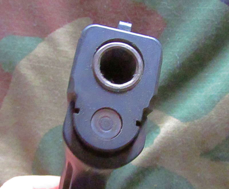

    What do you guys think of this… I noticed the slide on the new PM40 rattled around a bit. I held the end of the barrel in my thumb and forefinger and with just slight pressure it “pops”. Took a while to figure out that the rail on one side was actually popping out of the track on the slide. Field stripping it I can see a slight canting of the rail on that side (left side in the photos) appears to be angled slightly up from the frame wall, while the opposite side appears to be flat or even a little down. Ideas?
    On the 3 photos below you see the rail in place, the rail "popped out of place and finally the "cant" of the rail.
    Bill, I'd send those photo's to Kahr customer service. Looks to me like the metal rails weren't formed correctly before they were put into the polymer mold.
    I see a new frame in your future but only they can make that call.

        Me... I might try bending the front of the polymer clad rails together to make them symmetrical and maybe properly formed, but I wouldn't advise you to do that. I would email Kahr Customer Service with those photos and what you've explained here. They should fix that. The slide is not fully supported!

          IMO that frame is not right, I would strogly advise against bending the rails. Let kahr take care of it, Tey made the fokker. It should have never left the building like that IMO 'Even though 9-0%p the energy of the slide is on the back rails, the front rails are a guide to keep the slide in propper alignment. If u notice the back rails are squared to ride tight and preecise in te slide rail where as the front rails ar elike a blade tha tjust guide the front p[ortion of the slide. There is play in that area byut what I am sweeing is rails that will not ride in thayt slide front groove correctly.

                The frame on mine is narrower than the slide by a 1/16" inch.
                Speaks volumes to Q.C.
                  Here is a pic of mine.
                    Holy Cow! Like two different guns! Two different manufacturers!
                      Unusual QC efforts. Let us know how you make out Bill. Good luck to you.
