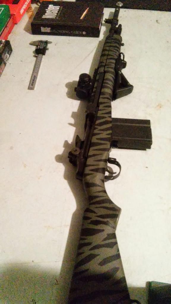

      What M1A is that you have? Looks like a socom from the angle of the picture?

          Hey thanks for the reply I figured some one on here has experienced the same thing... Im going to file it down later today how much material did you take off? The m1a in the picture is a scout squad I had a socom and sold it to buy the scout but both are nice guns...
                    What stock do you have on the scout? I have the socom 16 and it still has the crappy factory stock although i did some tweaks to tighten it up. It doesnt group real well with bulk ammo though. I put a bushnell trs 25 on the forward rail and practice standing and shooting gallon jugs at 50, 75, and 100 yards. I figure if i can hit those regularly its good enough to hunt if i can find a rest to shoot from.

                        Its just an old fiberglass Vietnam era m14 stock that i sanded down and spray painted with krylon and it fits pretty tight...[IMG][/IMG]

                          Hey boss, im not sensitive (well thats what the wife says anyway) so no offense taken here. As a matter of fact i asked her today how come shes 4'10" and has so much control over me at 6'1"? Something is just not right. Anyway I've got 7-800 rounds of mil-spec ammo I'm working my way through so come on over and we'll shoot some.
                          Got the socom last christmas as a family gift. I was looking on Freds website in the past and looking at the fiberglass, walnut, and birch stocks. The factory stock is too flimsy. Tried the scope mount thing and didn't like it. The socom sights are less than ideal. I put a bead on top of the front night sight which helped. The peep sight apature on the back is a little too big for my liking so i may change that one. The one nice thing I like about the red dot is its super light and low and almost will co-witness with the factory sights. If it get the irons like i want them the red dot is gone.
                          The thing is really fun to shoot and the compensator does help i think. Not to complain but for what the thing cost the stock could have been better.

                              I hear you I got lucky and mine came with a nice walnut stock I took it off and put the fiberglass stock on beacuse I didn't want to beat it up... when I had my socom it was pretty hard to hit anything past 100yrds with the brick of a front sight post that came on it... I replaced the front sight with a Springfield national match front sight and it worked great even with the overly big hole in the rear sight...
