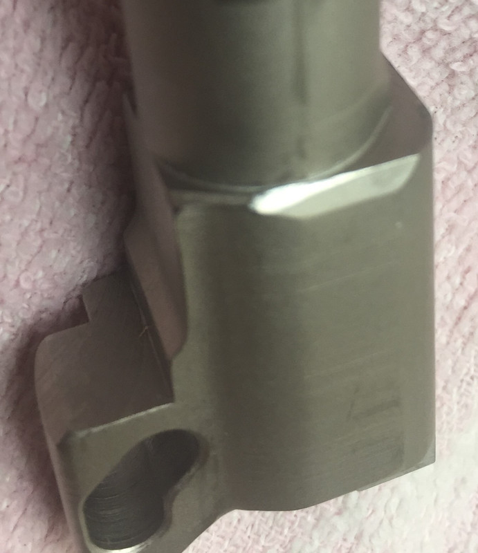

I have noticed some peening of the barrel on my . I was wondering if anyone else had seen this and if maybe it is a sign I need to change the return spring, it has 800 rounds fired and no malfunctions out side of the first 50. The slide shows no signs of it being hit only the barrel.
This is left side right side is the same. Thinking maybe just weak spring.
