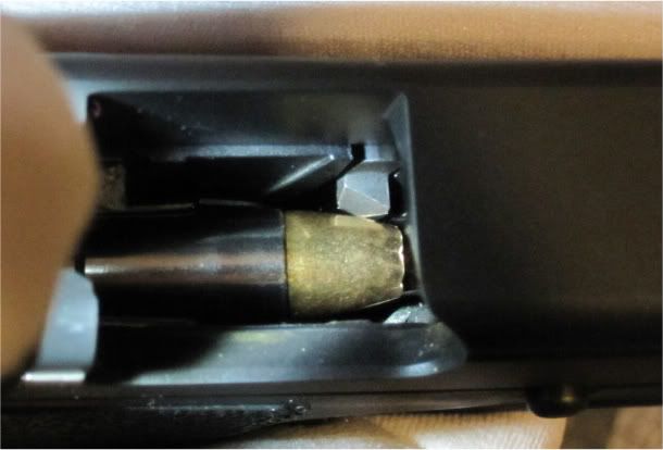

    I had the same issue on my new PM9 this weekend when I tried shooting Winchester Ranger (+P 115gr and +P+ 127gr) right after a 350 round break-in with Winchester White Box. As you can see in the picture below it is the same contact issue and I plan to contact Kahr tomorrow.

        email them, send the photo, photos do alot better than words. direct it to Jay or eoin at kahr.
        question: is that round moving up the slide stop lever or just glidding past it. Looks to me like a tad could be taken off that little nub right in that one particular pointed area where it seems to be making contact with the bullet.
        \they are not rated for +P+ but the round itself should make no difference..

          For mine it is interference and not just gliding past it. As you insert the magazine you can see the round deflected to the right. This is with the slide locked so one can assume without the slide locked the tendency would be for the round to first move the slide lock up (which it is). I'll be calling and emailing Kahr tomorrow. I have no doubt that they will take care of it.
            Here is a follow-up pic with Rem Green Box 115gr HP +P. Plenty of room.

              nice photo carl,
                SOLVED the slide-lock problem.
                See the conclusion of my other thread on this:
                http://kahrtalk.com/showthread.php?t=6066&page=2
