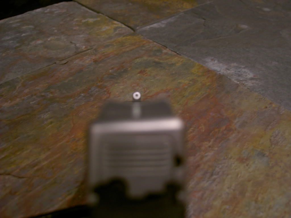

      I installed Big Dots on my PM9 and love them. I like them so much I got them for my P380 too. They're the quickest sight picture you can get, IMO. Almost like a 'red dot' in that you put the dot on the target and pull the trigger. These aren't "factory" but these are the clearest pics I've got:

              It was my first time doing sights. I removed the slide, cut two small pieces of wood and put them on both sides w/ masking tape wrapped around to hold them in place. I marked the factory sight positions w/ a pencil to help me know where to put the night sights in place. Put the wood sided slide in my vice, and tapped away w/ a hard wood dowel and a hammer to remove the stock sights. It did take some effort to get them moving.
              I then followed the directions by lightly filing the bottom of the sight until it can be put half way onto the slide by hand, then tapped them back into place w/ the dowel and hammer after applying some red loctite to the dovetail area. So far, so good!

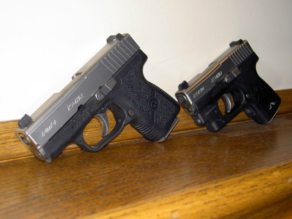

                I just installed the Trijicon front N.S. on both my CW9 and CM9... easy job.
                here they are.
                I like the single white line rear sight, I have more pistols with that type then 2 dot. I also think the front N.S.only works great for defensive use ... I also have lasers on both my Kahrs. I should be able to see something
                BuckeyeBlast installed his sights just like I would do it if I wanted to replace the rears on my Kahrs... Vice, non marring punch, then fit the new one so it goes on 1/2 way easy and loctite. I agree that Big dots are nice sights, have them on my Glock 26 good stuff! Just not available for the "C" series Kahrs... yet
                  To expound upon BEARDOG's excellent photos, here's what the Trijicon rear sight looks like installed on a "C" series pistol:
                    You may just want to do the front night sight on your CM9 like I did. Aquistion of a target in a dim/almost dark situ is easy with just the front. That's the sight you are looking for anyway. I do have the CT on mine as well.
