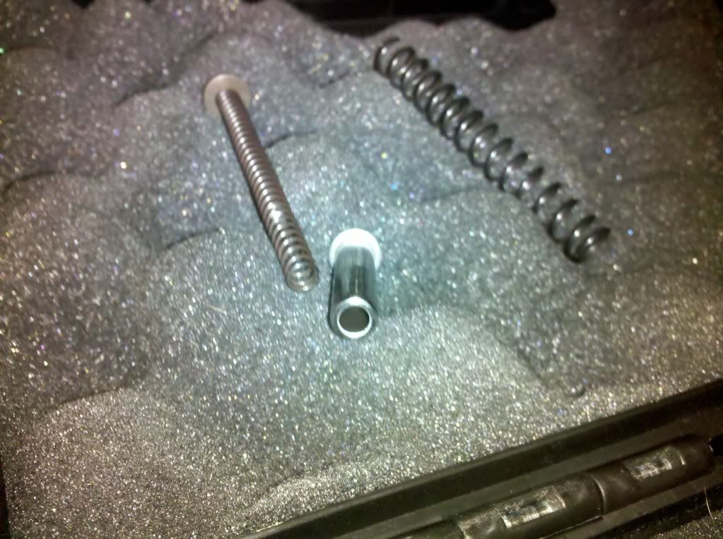

    Took the cm9 out finally to the range today. I put a little less than 200 rounds down range without any ftf or fte. However I was having some issues with the slide locking open after the last round had been fired(empty gun and mag).... I loaded 1-2 rounds in each of my mags and tried to duplicate the problem, but couldn't do it. It' was only happening every so often on a full mag.(using 6 round mags, one that came with it another mk9 mag) No big deal unless 7 rounds don't do it in a gun fight. Also upon coming home and cleaning it I lost a piece to my recoil spring assembly. Out of all the kahrs i've owned pm9 pm40 p380 ect I've never had that issue before. I sent Jay a email and hope he gets back to me soon. It's the little piece on the smaller spring assembly that I am missing. Almost like a nut of some kind. Either way I shot only fmj umc rounds and was very impressed with the little sucker! I'll have a winner once I get it up and running again. Until then it will be my 342, g27 and p238 as edc. Here is a pic of the recoil spring.

          They will most likely send you a whole new recoil assembly. A few of those nuts have come off. Wynn figured out what the thread pitch was and made his own for a spare. I don't think kahr sells the individual parts so you'll get the full deal which is as it should be.
            yeah, i was like wth is up with this spring... I pulled up a video just to confirm that I was missing something. I hope it doesn't take too long I still need a few more boxes of ammo thru it to carry it everyday.
              An email to Kahr CS with a picture of what's wrong should get you a replacement part quickly... OR make your own guide rod nut:
              http://kahrtalk.com/showthread.php?t=3934

                  Yeah I sent Jay a email before posting this thread.... any idea why it would come off so easily?
                    That union... the threads on the screw end of the guide rod and the nut... is supposed to be a permanent one. If everything was cleaned properly and the bond was allowed to cure, it's supposed to be permanent. Apparently, sometimes it's not. Loctite and such are a super-glue-like thread adhesive... NOT for plastic, as the union is stronger than plastic and if you have to separate them, the plastic might lose out to the bond itself. All of the technical instructions for those adhesives say DO NOT use on plastics... just wanted to point that out.
                    The gun will shoot without the nut. Most of us don't find it's missing until we take the pistol apart... further than normal! There's no telling what point the little sucker flew off... downrange!
                    If you have time and the inclination, you can do what I did in the posted link above. I did and had a bunch of the correct-sized nuts from keeping supplies of stainless fittings for the boats I no longer own.

                      Jay Emailed me back first thing this morning and I have a new recoil spring assembly coming my way. I'll advise everyone upon it's arrival and my follow up range visit.
