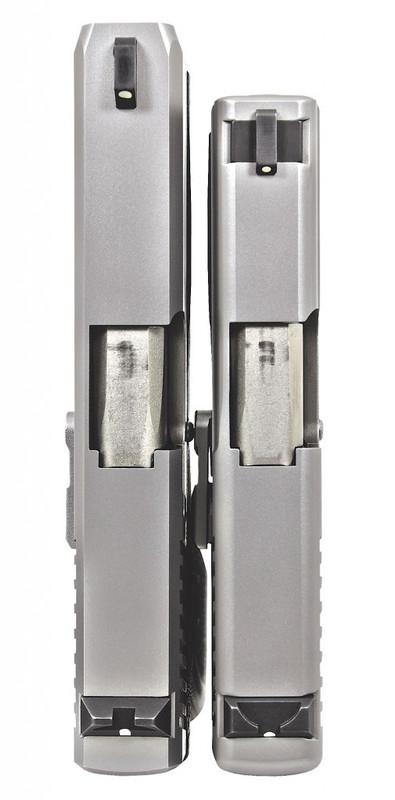

          Based on size alone I wouldn't see how it would be possible. But if you try it I would wear a helmet and 'tac' glasses
          http://www.handgunhero.com/compare/k...-vs-kahr-cw380

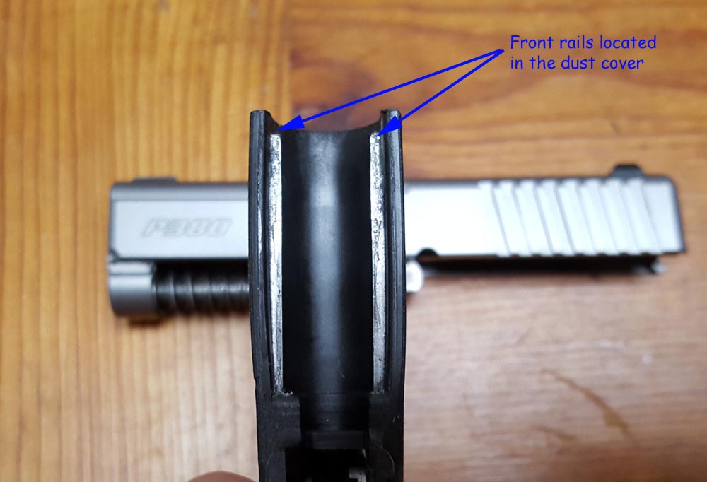

            That right there is the rub. The front rails on Kahr poly pistols are located in the dust cover.
            At first blush, I was tempted to doubt the dust cover of a CW380 is long enough for the CT380 slide to engage the front rails.

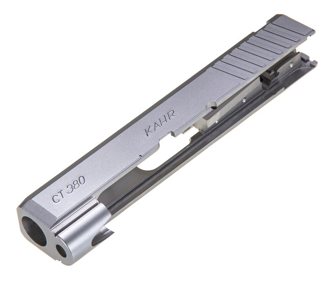

            However, after looking at the two slides on Kahr's website, I see the CT380's slide is longer where it engages the front rails. I think the possibility exists that that additional length might be enough to engage the rails on a CW380 frame.
            Photos from Kahr's website

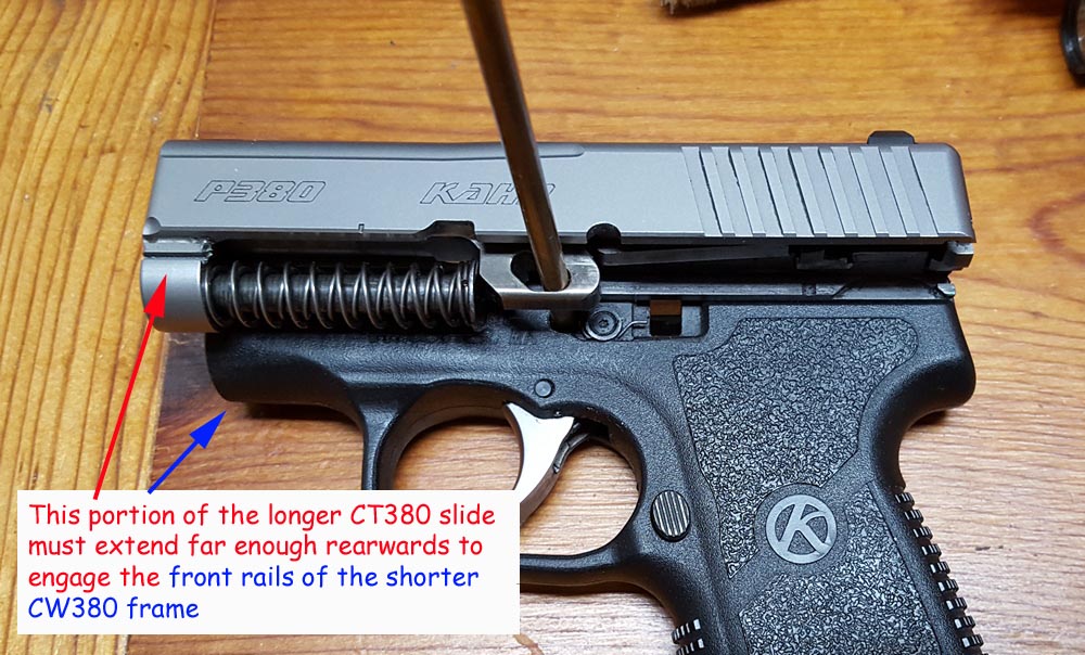

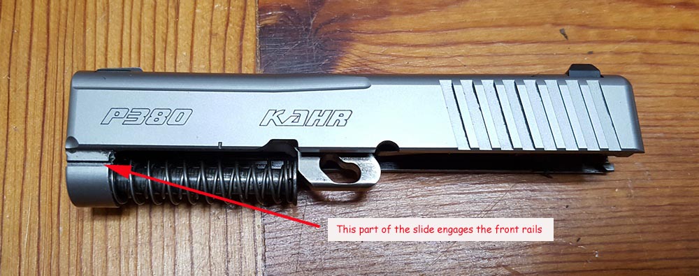

                I don't have a CT380 so I'm not speaking with authority on it, but let me try to explain my thoughts differently.
                Looking at the photos on the site dustkicker linked, it appears to me that the CW380 has a shorter dustcover than the CT380.
                As the front rails are located in the dust cover,
                The portion of the slide that engages the front rails,
                ...must extend far enough to the rear (compared to the front of the slide) to engage the rails when the slide is in battery.
                From the photos, it appears that the CT380 slide may be long enough to engage the rails on the CW380's shorter frame, but I don't know for sure.
                  Greg: Your response, especially with the photos, is most appreciated. I believe I now understand, exactly, the physical length and engagement to which you refer. I think another way to look at it would be the measurement from the rear of the longer CT380 slide to the beginning of the rail on the shorter CW380 dust cover. It would not appear to me that much "overlap" would be required?
                  The last image from your 1st post does give me hope: now, to find a store with both models available. This may proove easier said than done...?
                  Yor pictures were amazing! Thanks, again!
                    I can't believe I'm the only one here who has both pistols. While the dust cover is longer on the CT, the frame rails are located in the same position as the CW. The frames appear to be the same with just the polymer dust cover being longer. I hope this helps.
