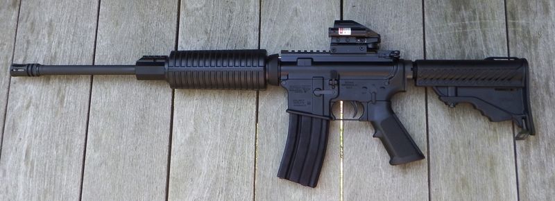

        I too recently bought a DPMS AR15. The gas block is lower than the receiver rail, therefore if you want iron sights on the gas block, you need to get a tall front sight. Depending on the type of front stock, you may or may not have rails there. DPMS sells both traditionally round and quad rail types. Changing to a quad rail, if not already installed, is easy but will cost a few bucks... as will the sights.
        Before you go that route, you may want to invest in either or; some Lock-tite for the screws, or a new optic that has better attachment points.
        Here's mine fresh from the box before I swapped out for a quad rail, but with a cheap optic I had added. Is this your model, a Oracle 15?
        That particular optic was about $60. Has several red or green reticle choices and a red laser. It proved easy to sight in and stayed put through my first range run.
