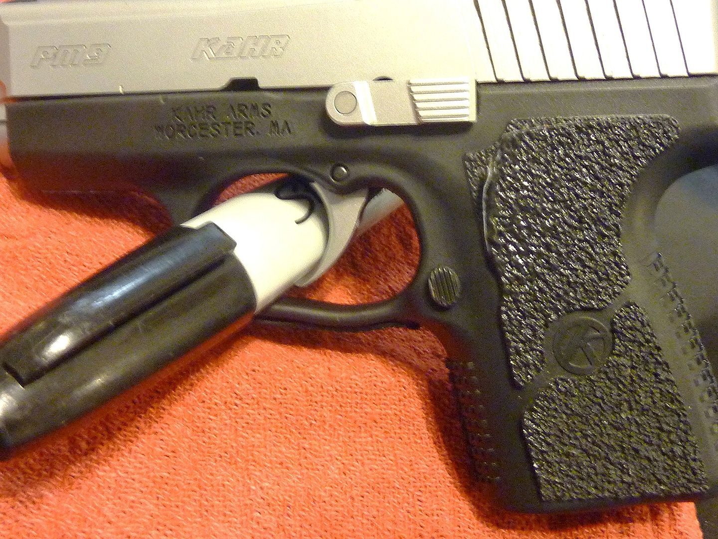

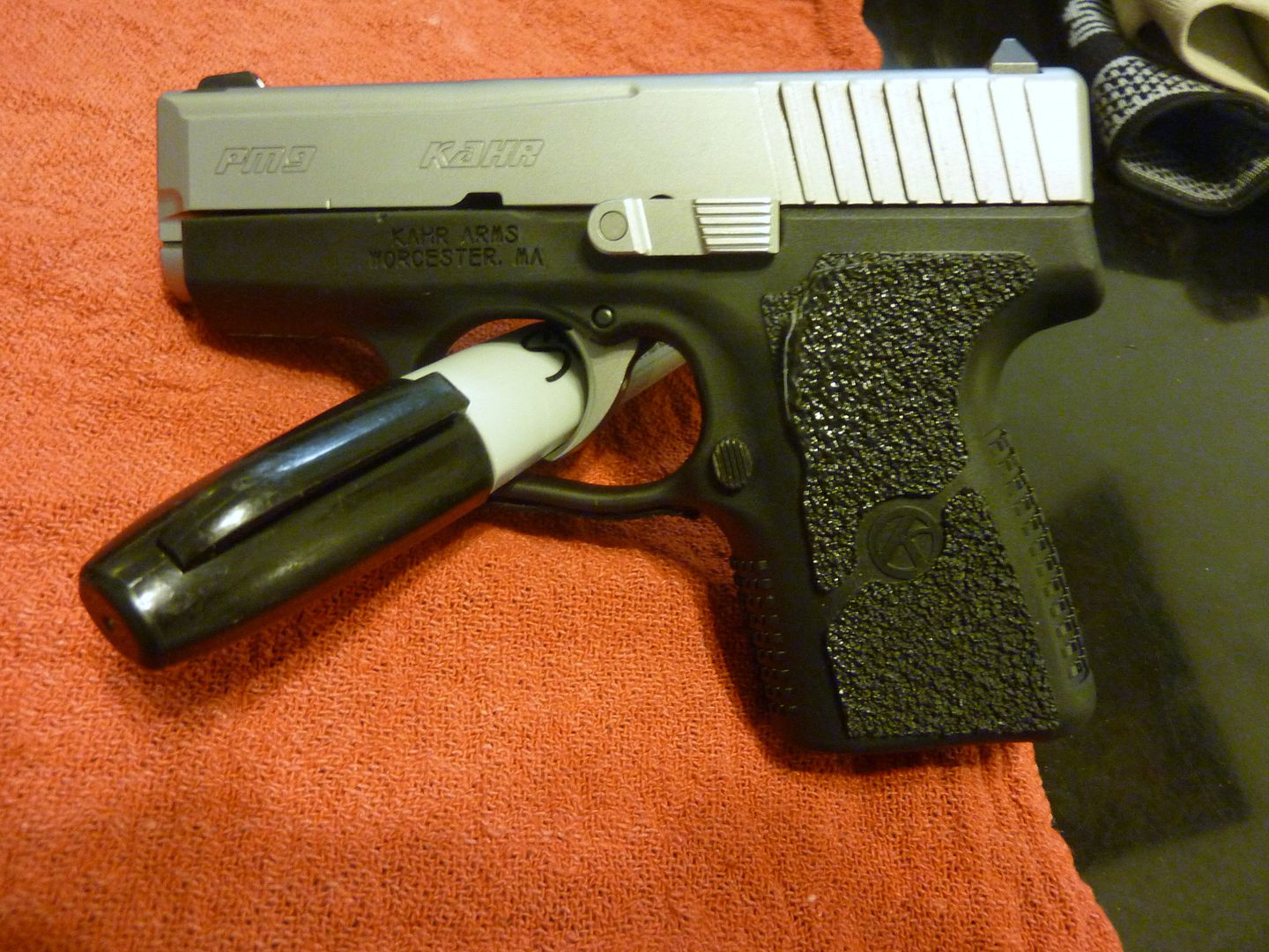

                      I used heat gun remedy, nothing else, though I initially started with a hair dryer.
                      Recommend heat gun on 'low' setting. On high setting singed grips a bit as too hot and may damage the firearm.
                      I subsequently went to 'low' a couple of times over the past days. I am truly done this time and pleased!
                      Be careful and don't expose to the heat for too long. Do incrementally as prudence dictates. Do so at own risk to the firearm!
                      Today's photos:

                        Great job. Can you get that grip tape off?
                        • #57
                          I would think so without difficulty. Just waiting on some new grip tape that I ordered.
                          The ones depicted are Decal Rubber Grip tape-they give quite a bit more traction than Talon rubber- a bit much for my liking...ordered some 'Traction' rubber grip tape (less costly than either Decal or Talon), should arrive in a few days. For a change, I just wanted something other than Talons.
