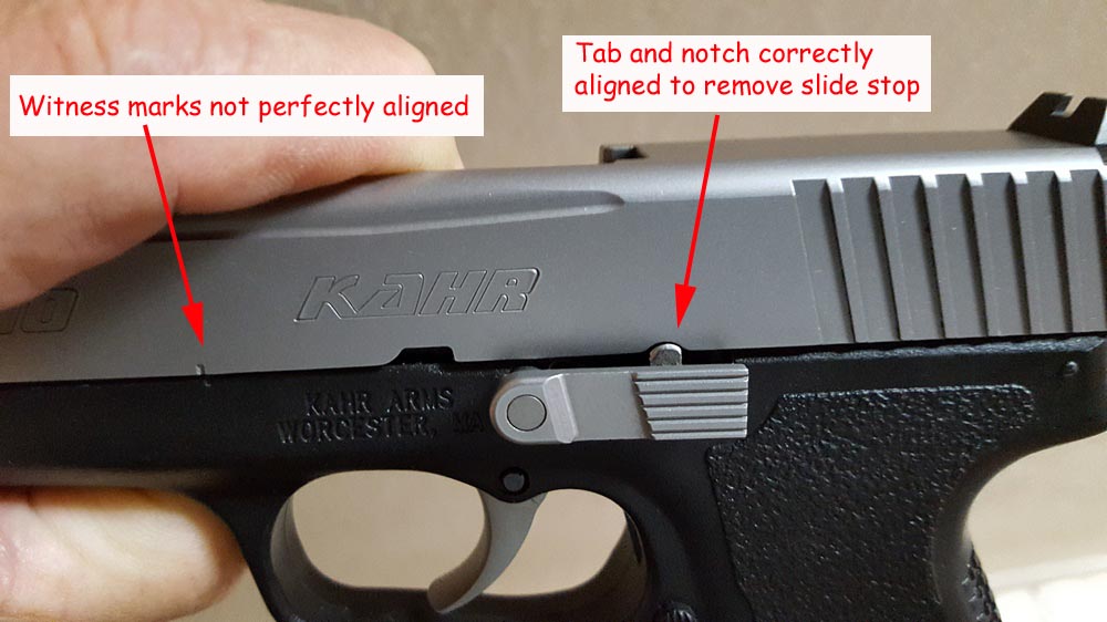

The line up marks are only a reference, I don't even look at them, you need to line up the cut out on the slide with the back of the slide lock levers little raised bump.
In the video Greg is lining up the barrel link, getting the slide lock lever pin in that hole, you can push the pin almost all the way in until that little raised bump hits the slide, then you have to get it lined up to finish pushing it in.

I've found those two witness marks to be approximate rather than exact. What I do is align the tab on the slide stop in the take down notch, then push the stop out.Originally posted by tkarl View Post.....
