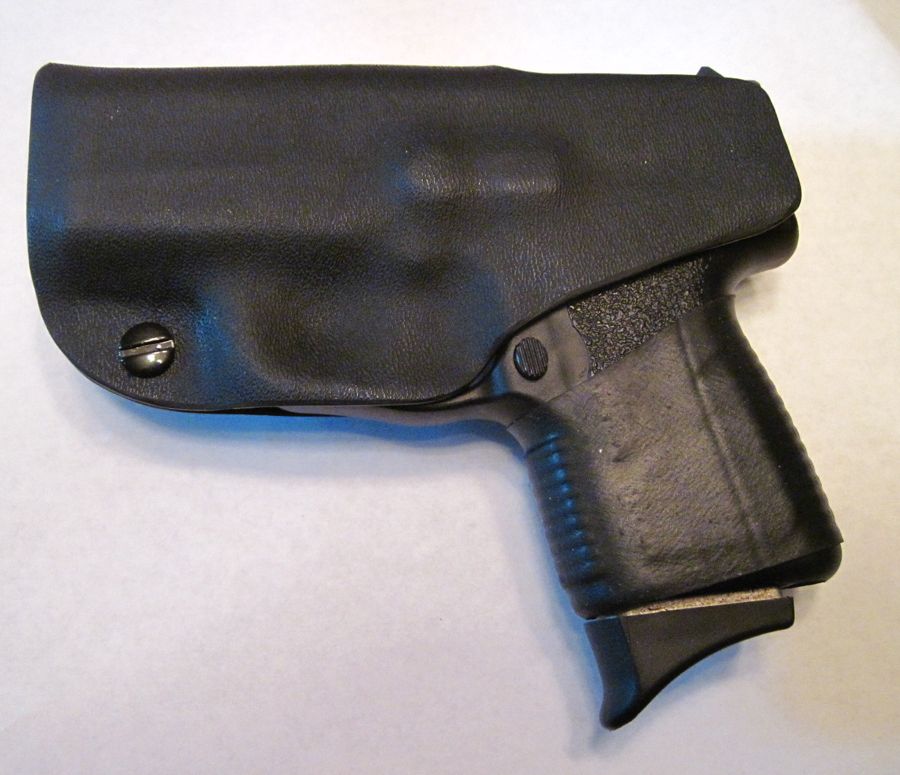

Yesterday I received an in-the-waistband PJ Holster for my CM9 and after carrying it for a day, I give it high marks for comfort, safety and concealability.
PJ Holsters (http://pjholster.com/) can be ordered with a variety of options, including the type of belt attachment and the cant of the pistol. But I wanted a straight-drop holster that I could wear at the 1 o’clock (or appendix carry) position, which is the most comfortable for me.

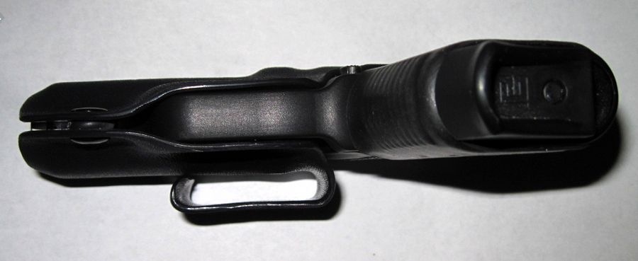

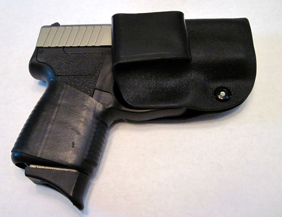

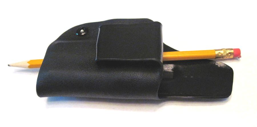

I wanted the holster to be thin, so that it didn’t add much width to the pistol, I wanted full coverage of the trigger, I wanted a fairly deep carry and I wanted an over-the-belt clip-on loop. The PJ satisfied all of these conditions.
The kydex used in the PJ is thin, yet very strong, and overall, it adds no more width to the pistol than does the Versacarry holster that I reviewed recently (http://kahrtalk.com/showthread.php?t...ght=versacarry)

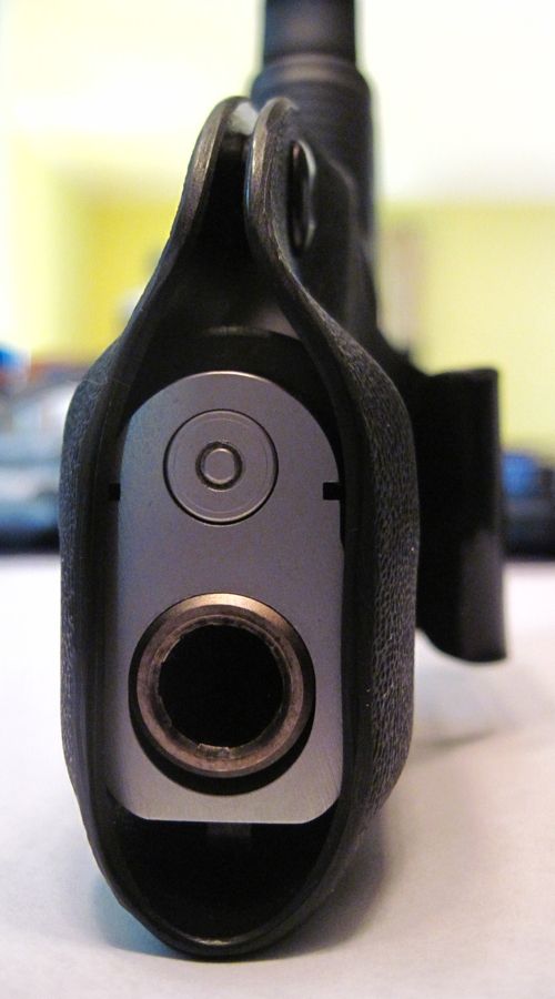

Unlike the Versacarry, the PJ covers the trigger on both sides, meaning that one can safely carry with a round in the chamber. The contouring around the trigger guard also supplies the retention that holds the pistol securely in the holster. The pistol holsters and draws with an authoritative snap because of this firm grip. The retention strength can be altered with an adjustment screw, but I haven’t tried this.
The kydex is molded snugly to the outlines of the CM9, but rounds them off, so that, for example, the slide lock lever doesn’t dig into the wearer. Also on this side of the holster, the kydex extends all the way to the rear of the slide, which acts as a barrier between the gun and the wearer, eliminating any chafing from the slide and presumably acting as barrier against sweat.
