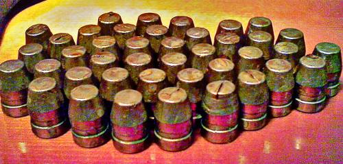

                        I would agree that chamber length is an issue. My std load is a 175 grain Lee TC bullet that I load to the shoulder.
                        Here is the bullet.
                          Here is the bullet.
                          Funny looking bullets!

                              I use the Hi-Tec Coating that Donnie Miculek of Bayou bullets (.net) sells. He makes great bullets
                              Mine are a BHN of about 12. I size them to .401" after coating them. I like the wide meplat that these bullets have. There are a few culs in my batch but they still shoot good. I use less than 2 cents of lead and coating per bullet.
