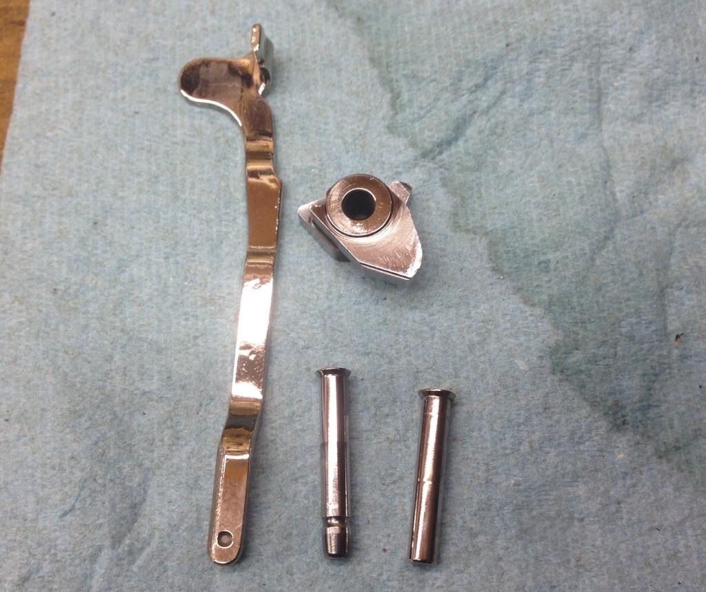

    Second - on the striker block, that portion of the block clears the striker by design, and there is a decent amount of clearance when you look at it in bright light. It does not even meet the wall edge of the channel, which is already clearing the striker, since the striker is smaller than the channel. Could be, as things turn out, the striker is rubbing on that side of the channel, but there's still clearance. You'd need a really really big sprue point to make some friction there.
    This was my observation of the striker block as well. There is no contact at the point the OP is concerned about. I'm not sure what the first part is, maybe the striker spacer?
      Yes its the spacer. Potentially a huge nub of a sprue could rub, but really, you'd have to damn near force the striker/spacer assembly into the channel to realize that. The ones I measured were "ok well finished" parts. Not perfect but 100 percent serviceable. If "perfect" they would have been a c.hair smaller than the striker. As it was, they were still well within any point of rubbing on things.

        My pistol now shoots properly after sanding and buffing those warts out, it's just that simple.
            True, I have not handled YOUR pistol, but your comment was that ALL of the CM's were inferior. You have miscategorized an entire line of product, and owe Kahr an apology for the same in my way of thinking.
            The fact is, it would be a real stretch for the parts you showed to present problems.
            The fact is, it would be a snowballs chance in hell to get two parts that both presented problems.
            The fact is, the CM's are not different than the PM's in all regards, except for those noted here, and on Kahr's website.

                CJB: I concur. I've been in machinery repair and failure analysis for over 35 years, so my training and experience demands that I notice subtle differences in machinery components. I have a CM45 and a PM9. I can dissassemble, flip the slide, look in the frame, and both guns are constructed and machined/finished the same, with the same components. Kahr would have no reason to misrepresent on that front.

                    Kahrmine, u must have had a reall sh!t kahr ouyt of the box which is very rare indeed. I have to agree with CJB on his points. The PM9 trigger is the same as the cm9 trigger, Parts come out of the same bin, kahr doesnt cut any corners on that stuff. Wehave seen trigger bars with a slight hitch when pulling it but when a poster comes here he is guided to that little springhy which rides uder that spring and to grease it and then shoot it and it wil smooth itself out, without total tear down. glad u got ur warts out of the way and the gun is doing asu say. the part that matter is if it works for u. I certainly never recommend any owner to completely tear down the trigger area of a kahr, fokk up the frame and ur outta luck. . But again some are moe gifted in doinbg these things, so each to his own. IMO utting beats shooting the gun and let the gun reak/smooth itself it. U can polish a wart I guess ...

                            Ok, I will concede I may have gotten a lemon, but only because Jocko chimed in.
                            One thing was that when I talked about this trigger, everyone said that the way it felt and was shooting was "typical." Really, I bought the gun knowing how awesome my PM trigger was. I dry fired it a ton and gave it the Jocko treatment, but when I got to the range it was obviously not right.
                            It's shooting straight now, so I can't complain.
