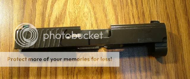

        Here is what the P9 slide looks like now. I still have some work to be done, that final little bit to get that mirror shine is a PITA!
          I'm attempting to do the same slide polish on my K40 with apparently much slower success than you. Did you find that some areas of the slide polished up nicer and faster than other? I just using a dremel with the cotton wheels and polishing compound. On mine the area between the rear sight and the chamber polished easy, from the chamber forward not near as nice. Sides aren't shining up to easy either. Have to get more aggressive I guess. I'm still pondering on jeweling the whole slide too, just sounds kind of slick to me but I better jewel some other stuff to practice before I go sacrificing my K40 slide.

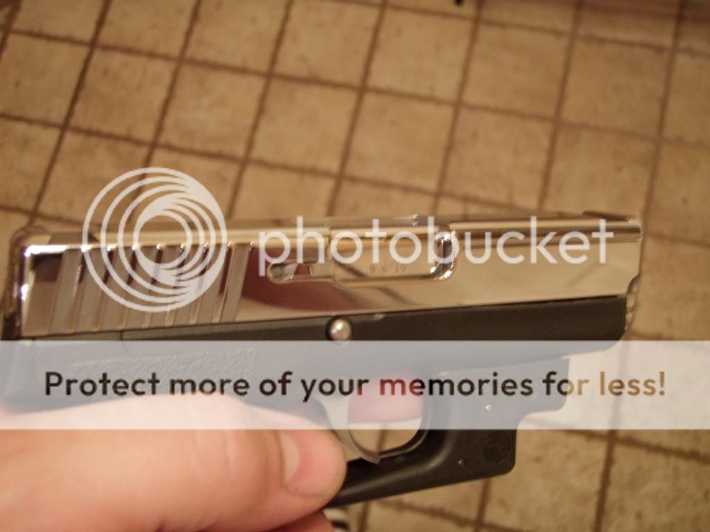

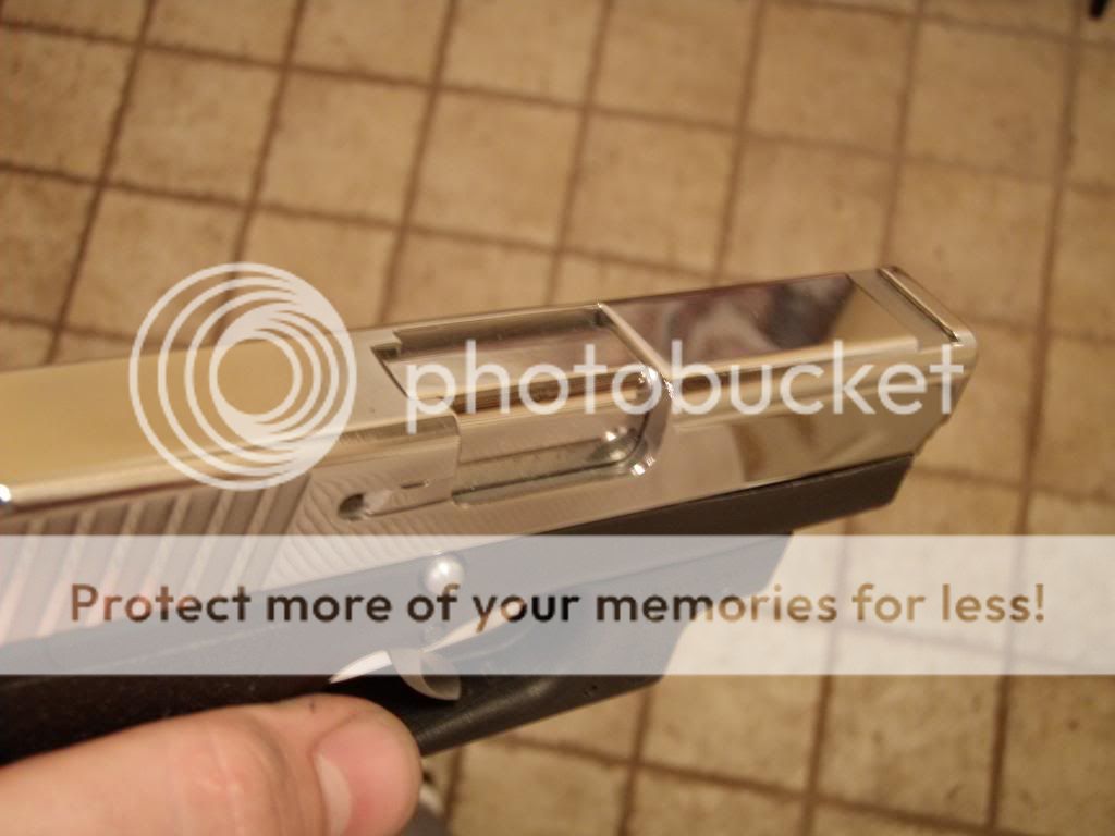

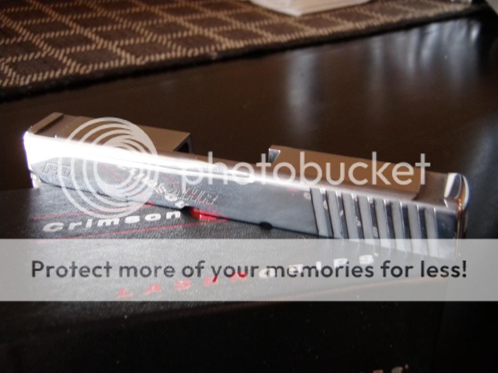

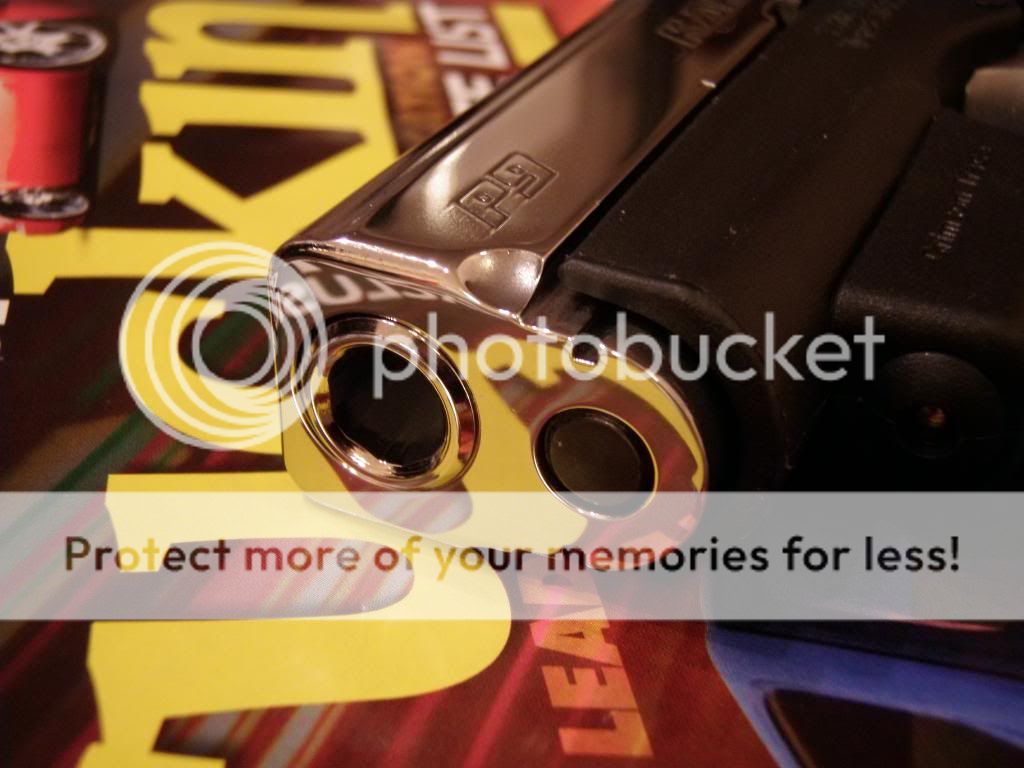

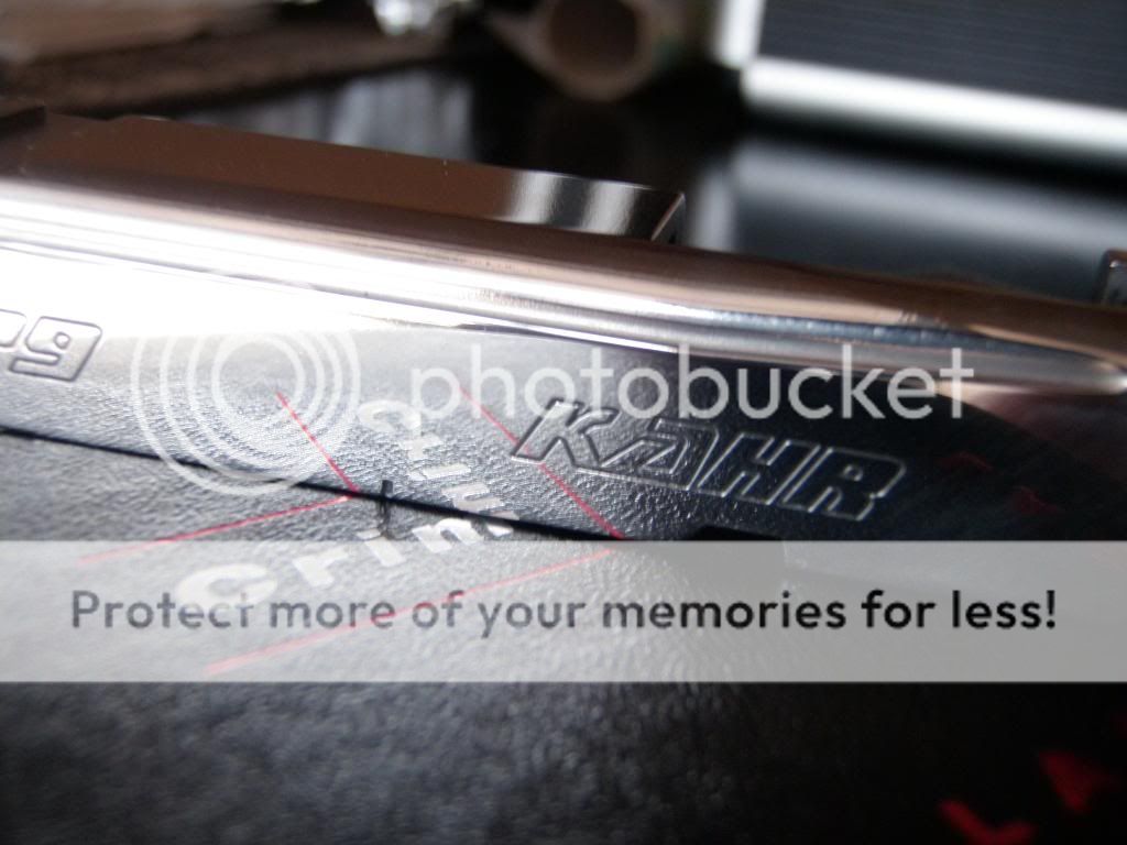

                        Done with the polish! There are some very small pores in certain areas that can't be polished away without really digging into it, and I don't want to go that far. You can't notice them unless you are focusing in on the object in the reflection. Also finished up the barrel, feed ramp, barrel hood etc.
                        Here is how she looks!
                          That is really looking fine! I had some reservations about trying it on mine but you've removed any doubt I had about doing it. I seriously doubt I'm gonna come close the quality of polishing that you've accomplished but it gives me something to aim for. Hope I don't get labeled a copy cat. I suspect there's alot of that around these parts anyhow and I'm thinking that's OK. Kind of what we do around here.
                          Very nice job! You've set the bar way high.
                            indeed a nice job, as good as any I have seen..
