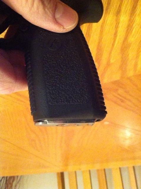

  • I hope I did this right
    [IMG][/IMG]
    • Thanks!

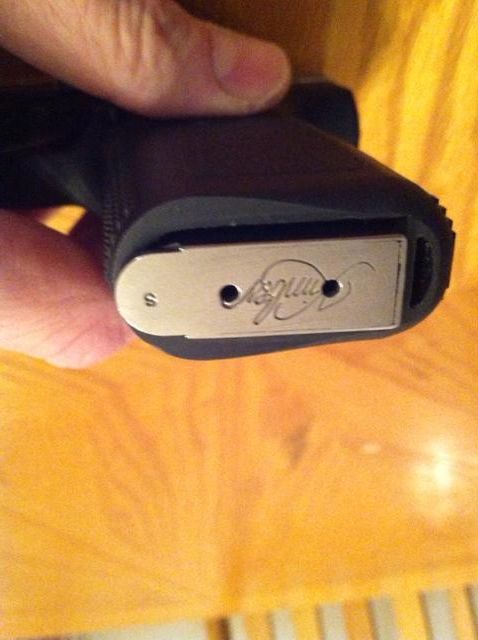

      • Before coming across this post, I bought the Kimber Kimpro Tac Mag for my CW45. It takes a bit to seat, but runs great (although only occasional slide lock) and solves a premature mag dump with Underwood 255s.
        Question -- what should I look for to determine if I need some kind of modification on this magazine.
        PS, slide lock not important to me -- flush mag and no mag dump is.
        TIA,
        Paul

          • Thanks Greg -- Do either of these conditions pose any problems other than making the mag a bit hard to seat?
            Thanks,
            Paul

            • Originally posted by paul105 View Post
              Thanks,
              Paul
              Paul,
              IMO, the slide hitting the top of the magazine (or, as in the video, the extractor hitting it) is never a good thing. I feel it could contribute to feed, extraction, or ejection issues as well as unintentional mag drops. I've modified all my magazines to eliminate the chance of this happening. As the material removed is ahead of the feed lips, I've not seen the mod have any effect on how rounds feed from the magazine. FWIW, if I install 1911 followers back into the modified mags (I use Kahr followers and springs in my Officers/compact mags), they work without issue in my Officer/compact frame size Colt.
              With the other condition, as long as you get full lock (plus, no dropped magazines) and you don't mind the extra effort required to seat the mag, I'd guess the major concern would be the little room for error when inserting a mag under duress (you might also consider that there could be accelerated wear on the mag latch or magazine). If it were my pistol, I'd still make an adjustment so that the mag is easier to seat.
              • Thanks Greg!
                I just hate messing with anything that works. It's not the mag catch and it only takes moderate pressure to seat the empty mag with the slide in battery.
                I was getting some random magazine dumps with the Kahr mag that came with the gun. I tried the "Velcro" fix outline on the site without success. The Kimber mag (as is) solved that problem with no fail to feed issues.
                I don't care about reload capability as this is my pocket gun (in pocket holster). If situation looks suspicious, I can have my hand in my pocket on the gun without anyone the wiser. As long as it functions with one mag it will serve it's intended purpose. I carry a 2nd, .44 mag revolver strong side while out and about.
                With all that said, I suspect it would only take a couple of passes with a file to relieve the tight mag seating.
                Thanks for all you help and the excellent thread/links covering most potential problems with CW45.
                Paul

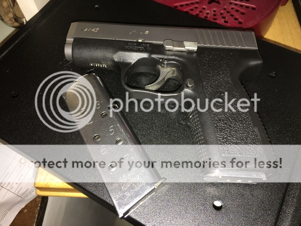

                        • I tried to follow suggestions in this thread, but failed pretty badly at it. Only 1 of the converted magazines works somewhat reliably, but it does not lock on empty. The rest jam on feeding or miss the pickup and let the slide close on an empty chamber. At this point I decided that it's easier to cut losses and bought factory magazines. 1 out of 3 refuses to work :-)

                            • Originally posted by zaitcev View Post
                              Looking at your photo, it appears to me that you are using 1911 magazines with "Devel' style followers. You might improve reliability with these magazines by bending the front of the follower down a bit (similar to the magazine on the far right in the photo below):
                              Then again this might not help and, even if it does, it's been my experience that this style follower (or most 1911 followers) will not lock a CW45 slide back consistently.
                              Have you tried a Kahr follower and spring in any of your modified 1911 magazines? This combo has worked without issue for me in my CW45.
