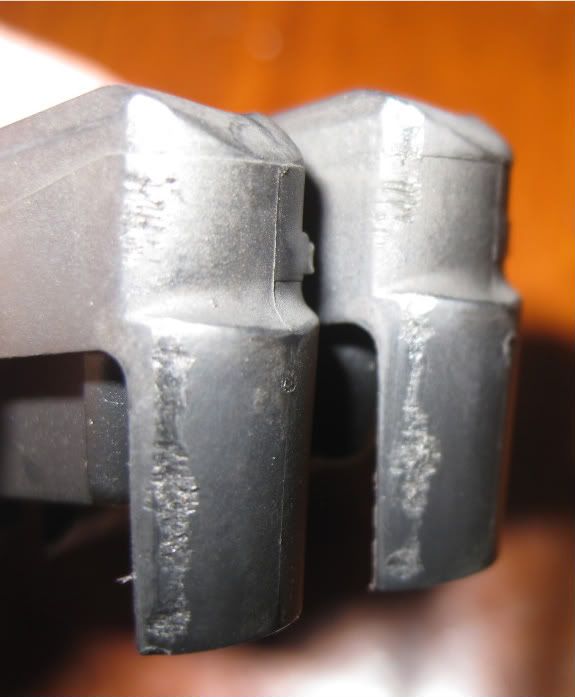

                May have found the issue. Shot today and upon the first mag drop, I found the follower was right at the window for the catch. Looked at the follower and found gouging! So instead of hitting rounds (or in addition to) the catch is gouging up the follower. Probably causing the catch to bounce release. I'll file the follower down and slightly touch up the catch itself. If that fails, back to calling Kahr.
                Pics of right front of both followers showing gouging from Mag catch. Did both with and w/o flash.
                  nice job of trouble shooting. Even if that doesn't solve the issue, it should not do that and filing/smoothing down that area won't hurt a thing either. That definitely cold cause premature mag dropping at certain round count. Just makes sense. We forum people should try to remember that when a poster comes here with a similar issue.

                            Well my efforts made it worse. Just took a little off both the follower and mag catch. Really just soothed the gouges out and took the peening lip off the mag catch. Fired about 5-6 mags worth and had a mag drop alost every other shot. One mag dropped four in a row and the other dropped three times in a row. So it's definitely not just happening at the follower.
