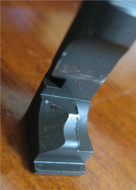

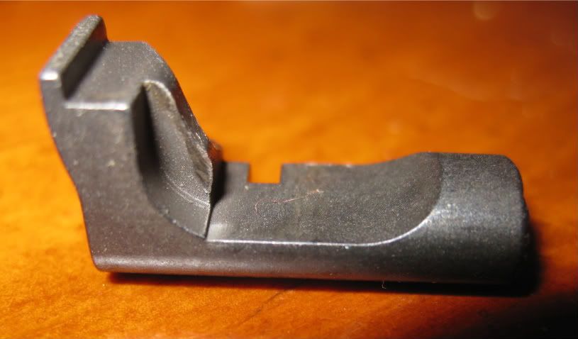

        Here's a pic of the mag catch after 100-rds. You can already see the edge peening. This is what most likely caused the follower gouging before. Crappy metal, heat treating, design?
