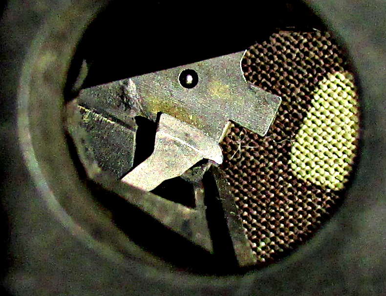

    I doubt if it is going to fix itself. I tested the extractor by pushing brass up through the slide without the barrel in it of course. It was way tougher to do than in other similar guns. The brass is tipped up a bit as it starts into the extractor.
    I took out the extractor, it was beveled at the bottom, but not smooth enough. The edge was sharp enough to dig into the rim of the brass. I radiused the edge on a stone.
    I lived with this gun for nearly 4 years giving me intermittent FTFs. I bought it used and figured that it would break in.
    muggsy posted the tip recently.
      Here is a pic of the installed extractor looking down the slide. Note the radiused shape at the bottom of the extractor. I thinned it from behind a bit too.
        anutter thing many do with the extractor is file off about .020 off the end of the long rod that goes in the extractor channel. This seems to loosen up the extractor a tad, for if u test kahrs extractor, it is one stout M**##ker.. Just sayin

          I didn't want to get a failure to extract and after polishing the spring ends and rod end on the extractor control rod, the brass was still very stiff getting started into the extractor. So I modified the extractor claw only at the bottom though.

              I had a lot of problems fixing my P40's FTF's... my rounds would catch at a 45° angle going into the chamber. The rounds would c0ck in the chamber and if I just took the slightest bit of pressure off the round by gripping the slide and starting to move it rearward, there would be a click and the round would pop up into place and chamber easily as I released the slide. I tried all kinds of polishing the chamber mouth before addressing the extractor. I tried sliding the cartridge up against the breechface to check the clearances and decided to radius the extractor surfaces that come into contact with the rim of the cartridge... problem solved.
              This problem took me weeks to solve. I... and others... thought it was a problem with the chamber. After many attempts to polish the chamber and repeated trips to the range for testing, I finally looked at the extractor.
