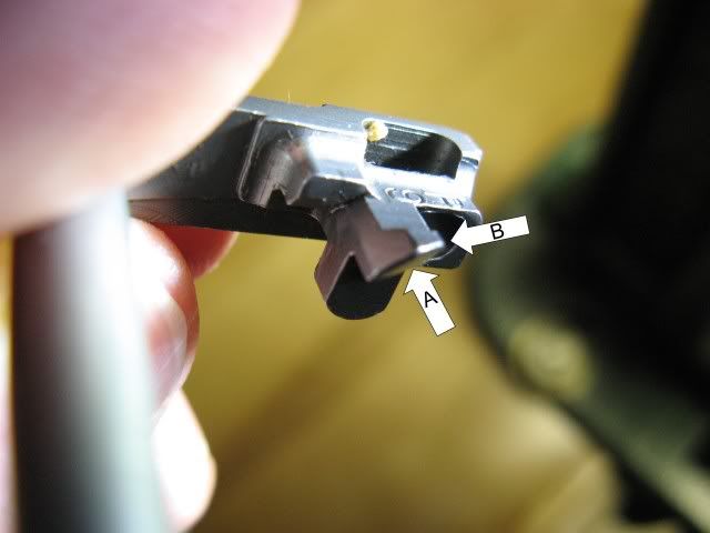

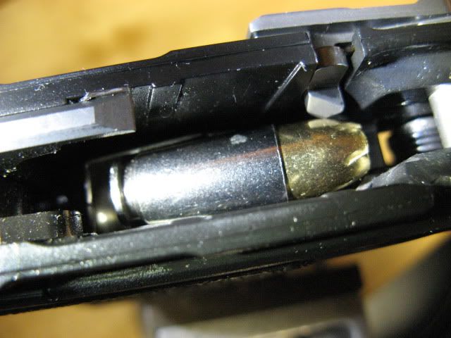

                I took a few pics to illustrate what i was thinking of doing.
                A- take down that flat area slightly. B-Remove any point.
                See how the fat nosed 124gr Golden saber hits the underside of slidelock.
                  Hi texjames,
                  Good pics. Actually the point right above "A" label is the point on the top of my diagram. Note how that point is what is touching your ammunition in the second picture. I don't see any need to remove the point at "B". What I did was eliminate the point above "A". I tried to make a flat line between "B" and the point on the other side of "A".
                  I tried to photoshop your picture a bit to show what I did, although it may look more aggressive than you would want to file. Keep in mind that I filed it up and down as if I were running a file up and down through the magwell, but I certainly filed the part OFF of the gun. Remember to keep checking the landing on the underside, you don't want the mag not to push up on it when empty.

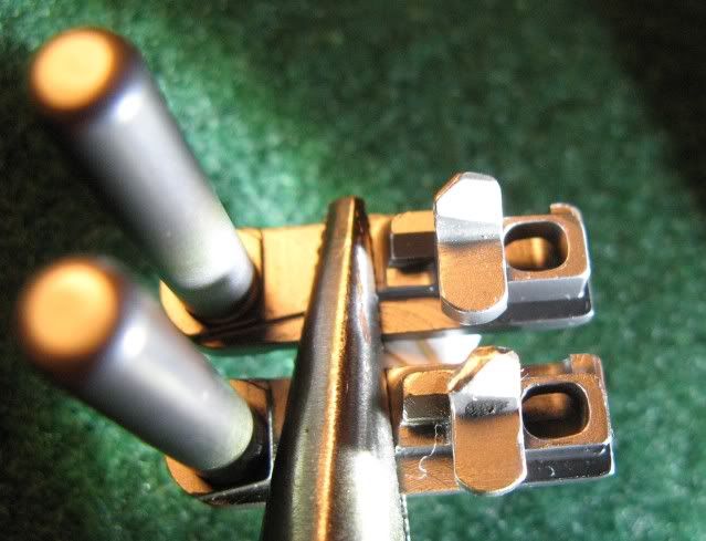

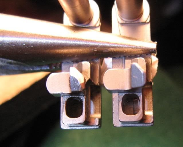

                            The modification i did on my slide stop as i indicated above on A&B,
                            a little bit at a time, making sure slide stop still worked on empty mag.
                            I used a file and dressed it with a diamond stone then buffed it with my
                            dremel and jeweler rouge....
                            It worked.I went to the range to try out some new 45acp loads so
                            took the PM9 and those Remington 124gr Golden sabers that would
                            lock my slide back nearly everytime, two 6 rd mag no problems.
                            So i have the new stop io ordered as back up if needed.I tryed to take a pic of the modified and unmodified together but did not look right,
                            I might try again later.
                            modified on left...
                            modified below is lower slide lock
