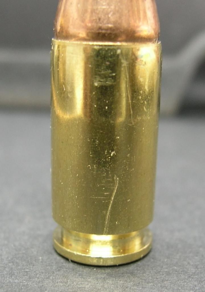

    Went to the range today with my Kahr CM 40 S&W with some new ammo and right off the bat I could not chamber even the first round. I figured oh no, just like the PMC ammo that wouldn't chamber. So I reloaded one of the 6 round mags with Winchester ammo that has always worked and they would not chamber either. I'm thinking what the heck is going on. Maybe the mag went bad so I tried another 6 round mag and got the same results. I then put my 5 round mag in and had no problems at all. Now I'm thinking, both my 6 round mags went bad at the same time?
    Anyway, when I got home and started looking at the rounds that would not chamber(about 10 in all), I noticed each one had a deep scratch on the casing. So now I'm wondering, is there something wrong with the gun? I have put almost 200 rounds through it so far so it's still pretty new and just starting to break in.
    Any thoughts or suggestions? Can we post pics here? I have a pic of the scratch on the casing.

        Thanks for that recent thread, the scratch is almost identical. I'll take down the Kahr tonight and check everything and also check the mags in question. Here's a pic of my scratch.
          Why does the picture look like the case is crimped at the top? It that just the lighting or is the case bent? Can you post a picture of the complete case from top to bottom?

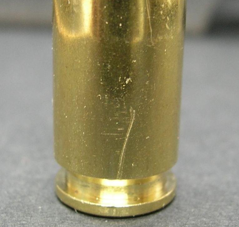

            It's just the lighting but I double checked just too make sure. Here's another pic of the same round.
              OK, I found out what is making the scratches, it's the magazine itself when loading it, it rubs up against the metal flange on the right side, the side that the flange is sort of angled down . All of my mags are like that so I guess that's the way they were made.
              Maybe I can file down the sharp edge a bit on that side. Another thing I just found out is if I download the mags with 5 instead of 6 rounds, then they will chamber. Could it be that the springs are already starting to wear out after about 80 rounds through each of them?
