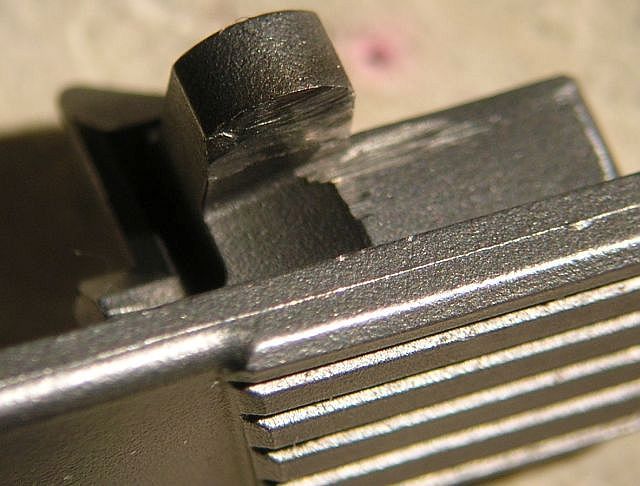

                    Well, I detailed the other mag and no go, matter of fact I can't get any of the rounds to chamber in this one. I think I mentioned this before that it was suspicious that both mags did this on the same day at the same time so I decided to strip down the gun and take a close look at it. Looking under a microscope, I think I see the problem but I have no idea what caused it or if it came that way. It looks like there are gouges in the metal and also the plastic is being destroyed. It almost looks like the spring where the slide lock may be bent. I know I was very careful when I did a field strip to clean everything to make sure that the slide lock slid under that spring but I never looked under the microscope before. Something really doesn't look right especially for only having slightly less than 200 rounds through it. Here is a pic of the slide lock that looks like something is scraping it.

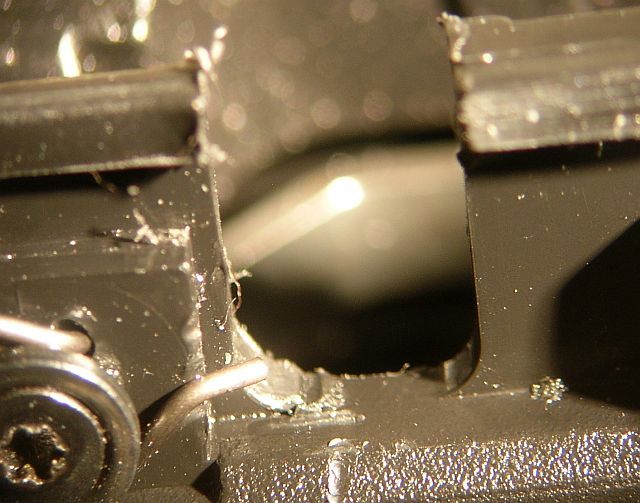

                      Here is a pic of the frame showing the spring and surrounding areas that are being chewed up plus maybe the spring is bent, I don't know?

                            I sent a picture to Kahr and they said the spring is bent in a little and will send me a new one.

                              Yeah, that spring is bent pretty good. You can see at the red arrow where it has been rubbing the frame. Here's how an unbent spring looks (you can probably bend yours back into correct shape while waiting for the new one):
                              FWIW, the green arrow points to some gouging that can be cleaned up or left alone, but I'd knock down any corresponding sharp edges on the slide stop. The blue arrow points to some slight gouging most likely caused by not having the slide stop above that area when pushing it into place.
                              In regards to the slide stop wear, some of that is probably normal wear, but I'd guess some might be because the stop spring was bent and the stop was contacting the slide more than intended (especially if your a lefty and shoot thumbs forward). However, I would check the slide for any burrs or other things that could contribute to that. You could clean up those areas of the slide stop a bit.

                              The spring may be the culprit. I've played with that spring's tension and position found it can be manipulated to the point it caused feed issues (hand cycled).
                              Make sure to properly lube the slide stop pin and barrel lug.
                              Check that the extractor is operating correctly (too much pressure or too little movement can cause feed issues).
                              BTW, those are very good photos
                                Thanks for those tips, I'll see what I can do while I wait for the part. Also thanks for the good words on my pics. I also build 1/25 scale model cars and have learned how to use the macro for getting close up shots of the detailing I do on them.
