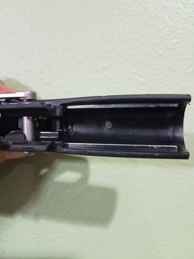

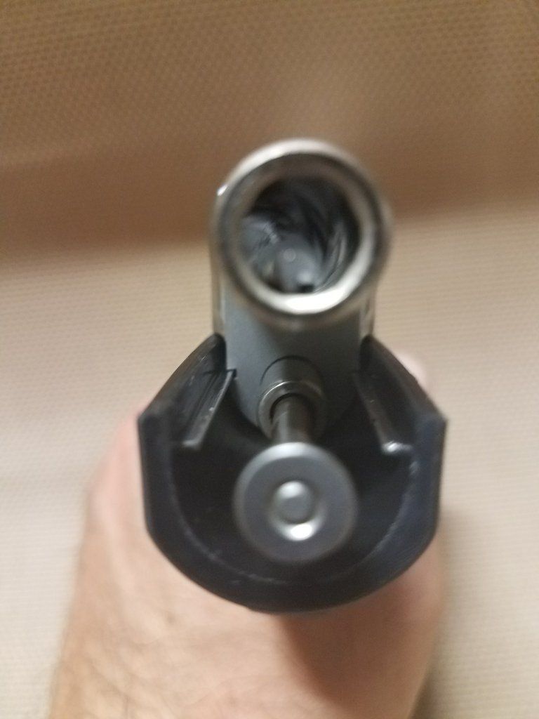

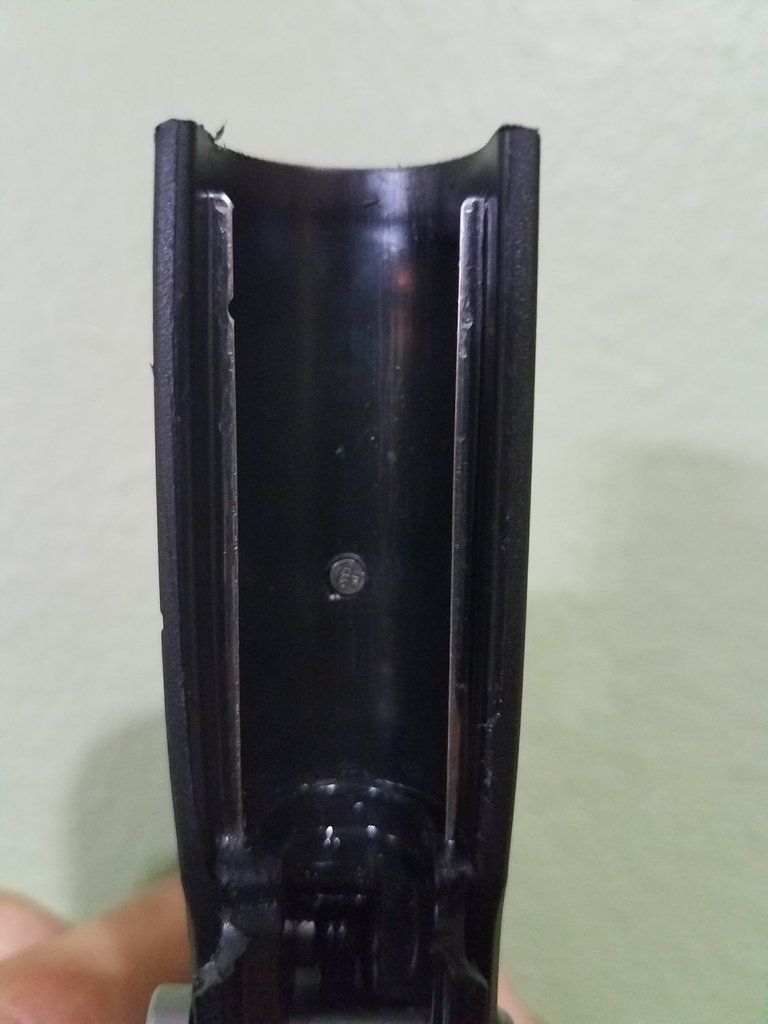

    Upon inspection of the grip housing is were my first questions come in. Since I am new here I am not sure of my photo posting rights and haven't really looked into the bandwidth etiquette of the forum (My Walther forum is a bandwidth Nazi) So I hope it is OK to include embedded pic from photobucket...
    Please review the photos and here are the questions I have:
    1. When looking at the left side of the grip housing there is a VERY clear bulge, disproportionate symmetry, etc on the left side vs. the right on both the polymer of the housing and the amount of metal of the slide rails. The picture doesn't do any justice to this but when I was trying to show my wife something else she immediately asked me "why is that bulged out right there?"
    2. There is MUCH more exposed metal on the left rail than the right rail. Is this normal?
    3. The left rail has a "witness mark"/missing material about a half of an inch from the top that can be seen in the picture. Is this normal?
    4. You can see some of the polymer burring at the very top left of the polymer grip and if you look closely, at the bottom of the right rail about 1/2 inch up. Of course I can remove the left side easily but I want to let you know that the right side had a big "glob" of polymer where you see the burring that I removed with my fingernail. Are these type of production issues normal? Should I sand down (lightly of course) the rough plastic that is now left on the right? The "glob" was not due to manufacturing in itself. It was clearly created due to friction between the moving parts. I should have kept it and took a picture but did not. It the same type of glob you would get when using a dremel or drill on plastic.
    5. There is alot of tooling/stamping AND wear marks & irregularities happening already on the metal rails that you can see in the photos and I can see and feel greater in person. Should I sand/polish this away?

    The buldge you mention is normal, no concern. The excess pieces of polymer as you say can be carefully trimmed with an exacto or sanded.
    The witness mark is indeed just that. It's there to correctly orient the metal to the polymer. The rails are actually one continuous piece, not just a little chunk stuck in the frame.

              The gun looks ok. I'd go shoot it and enjoy it.

                    To address your concerns:
                    1. As folks have stated, there is a "bulging" of the frame's dust cover on Kahr poly pistols that is considered "normal". With the slide in place, the bulge is slightly asymmetrical on my CW9, CW45 and P380: all have sightly more material to the left.
                    2. The rails on my poly Kahrs seem about equal to me. That yours don't may or may not be of concern. How much engagement do the rails on your pistol have side to side with the slide?
                    Here's what my CW9 and CW45 look like with the slide locked back:
                    It's difficult to show (in a photo) the engagement with the slide forward, but you should be able to see it in person with a flashlight.
                    3. Bawanna's reply to this was spot on.
                    4. If you are talking about the polymer in this area:
                    I'd clean it up. Some care needs to be taken when installing the slide as it's easy to mar the poly if the slide isn't centered when you start to slide it on.
                    5. I wouldn't mess those rails or I would at least wait until I had several boxes of rounds down range to evaluate if they need any TLC.

                      Thank you for your post and information. I finished my initial inspection/clean/lube/grease on the rails of the slide following the Kahr Manual and what I have read here in the pre prep of a new Kahr. Here is what I have discovered.
                      1. Yes, the chewed up areas on the back of the slide rail of the polymer grip were noticed (the ones you bracketed in red) but I was more concerned with some serious material removal/displacement/replacement that was on the right rail about a half inch up from the top of the red on your bracket. Eitherway, I decided that Khar build it for a reason like they did so I just took a few different Hoppes plastic picks and gently scrapped off and removed anything along the housing that didn't see to be "factory" that would let me do so. I wanted to clean up the bracketed area you showed me but I had no idea what the original geometry of those rails are supposed to look like so I moved on. FWIW. I agree about careful alignment when reassembling the firearm but do understand, this "damage" wasn't done by me. I had never removed the slide until right before the photo was taken and only put the firearm back together tonight.
                      2. I reviewed your pictures on the metal rails of the slide on your firearm. Here are are mine. I am concerned with the large gap on mine on the right hand side but am even more concerned with the left side having absolutely no gap. I guess that is where all the fine metal glitter all over my hands again tonight is coming from possibly?......(and sorry, I am not as good of a photographer as you are sir.)
