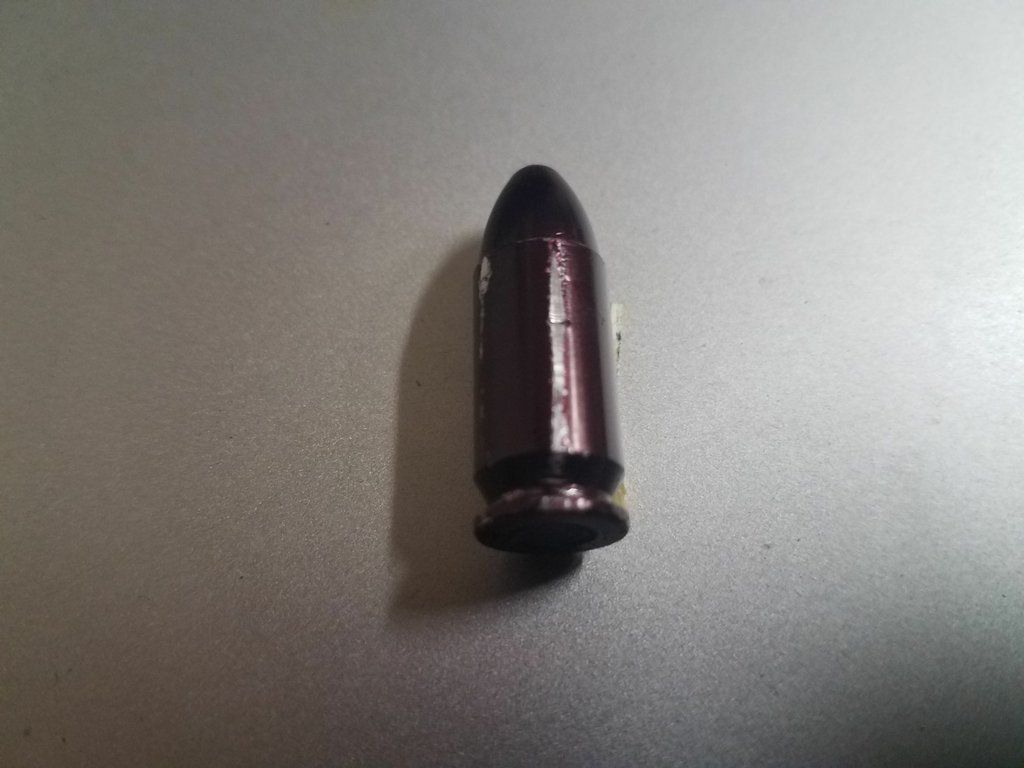

1. After racking the slide back and letting it go forward there is a very noticeable "BUMP", "grab" & Jump in the motion of the slide. If you rack yours back and move the slide forward, all of this goes on at about the same point the witness mark on the slide is on and passing the "M" in Kahr ArMs" on the grip housing. This is also the area on the left rail that is kind of chewed up before the "witness" mark on that insert that I talked about in an earlier post. Am I overthinking this? Let me know anyone if you have time to check yours.
2. Noticed Slide does not sit evenly on the grip housing. Do not have a caliper to check but I can get 4 sheets+ of paper under the front of the slide and only 1 near the back. You can see daylight easily on the front. You can also easily push down gently on the slide and see it go down in the front. Normal?
3. Just like the LCI, I am sure that there has been even less talk about the safety. I don't plan on using it but wife insisted as stated in earlier post. Concerned with the safety engaged and weapon cocked or not when pulling the trigger sometimes the trigger will hang half way through when you release it. It is PAST the breakpoint so I do not know if that is an issue or if someone could have this happen and then take the safety off and BANG. I know this wont happen with me but seems odd that it comes up and repeats regularly but not all the time.
Thanks for the info on the metal glitter. Just so you know I have cleaned it twice since I have broken it down twice (full clean, gun scrubber, Mpro 7 cleaner, re greased, lubed, etc.) and still get the glitter. I know it is a new gun so this will go away and since this is my first Kahr and they require a break in period I am fine with the glitter. Just wanted to make sure that you knew I cleaned my weapon well..twice...there ain't no factory anything left on that baby! :-)
