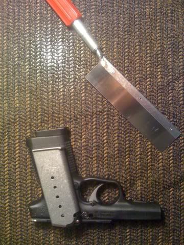

    The first pic is just the magazine overlaying, to get an idea for the first cut.

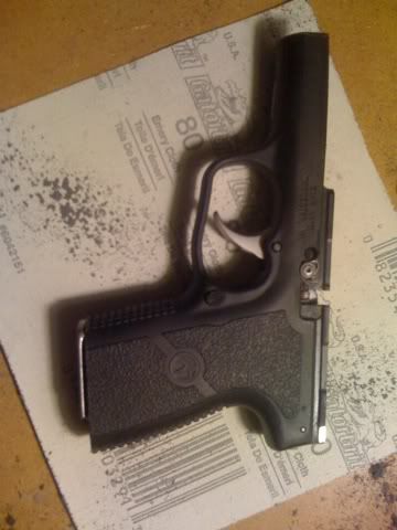

    Here is the first cut. I worked very slow and used the grip texturing as my guide. I figured I'd cut it long and sand the rest. This gave me plenty of room to work with.
    After a lot of sanding

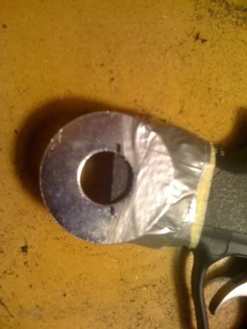

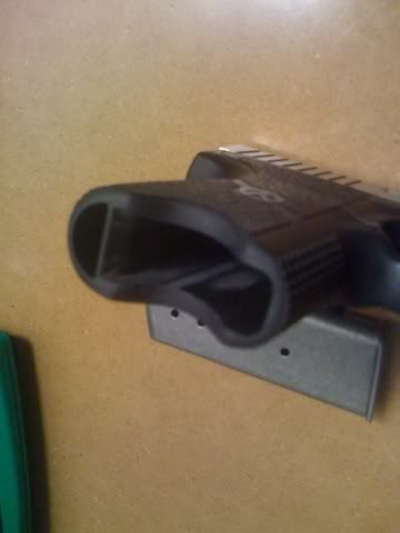

    I decided I want the magazine as flush as possible, and I also wanted mag well cut outs. So that worked out nicely together. I used a washer as a guide for my dremel and sanding drum.

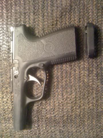

    And even more sanding, starting at 180 and finishing at 600 and a 3M extra fine pad. I also added a new bevel inside the mag well.

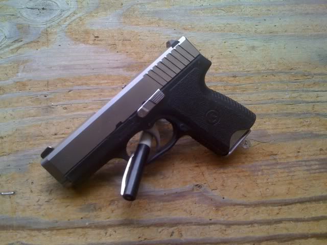

    Good to go, it now resides in an "Uncle Mike's #3, right front pocket. I'm going to pick up a multi tool pouch to carry a couple 6 round mags. Still shoots great, both 6 and 7 round mags. And I will admit to running it a bit dirty.
    I'll admit I was a bit nervous but I think it went well. It actually wasn't that bad, I just took my time. If your thinking about it, all I can say is go for it. It's not really that hard.
